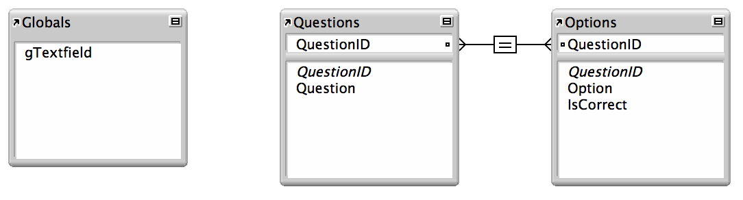

For best results, make each question a record in a Questions table, and each option a related record in an Options table.

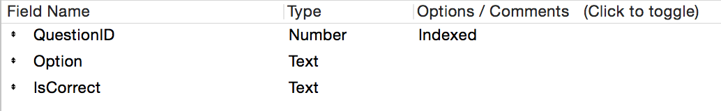

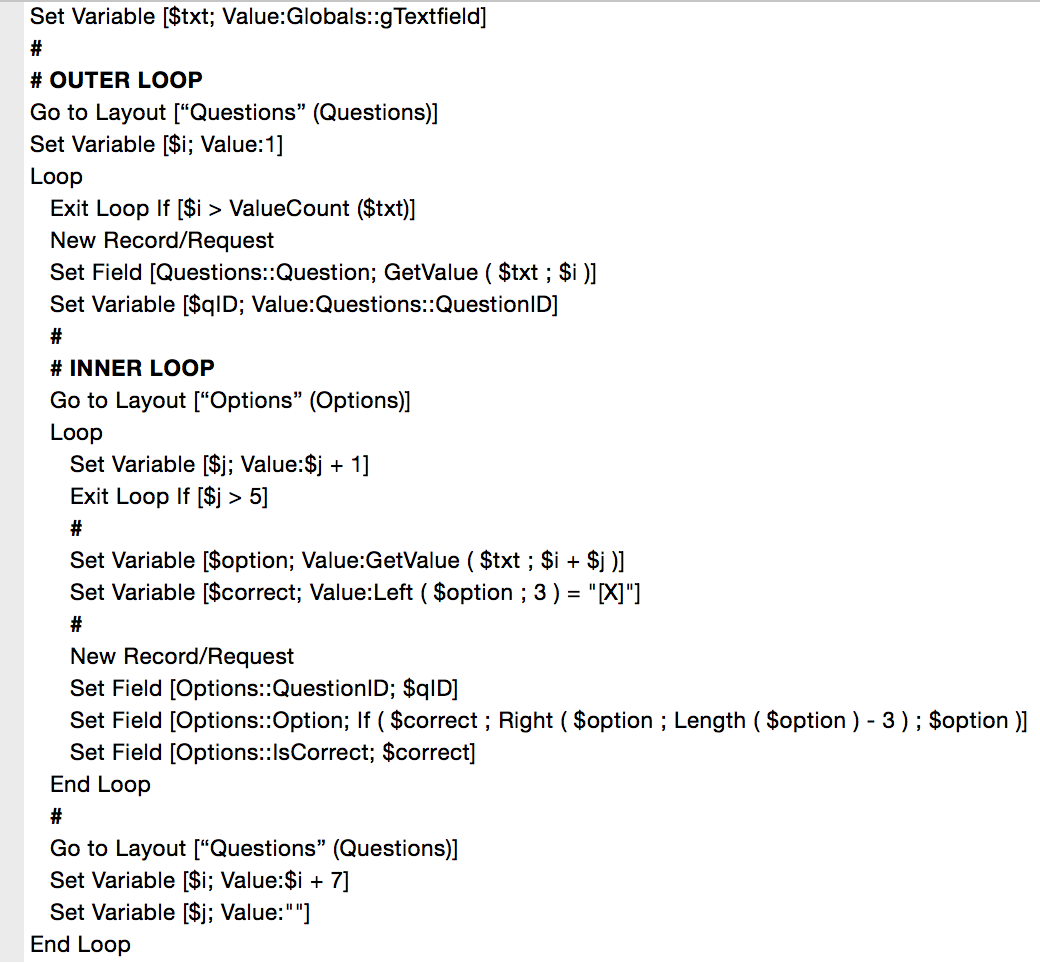

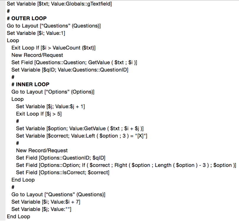

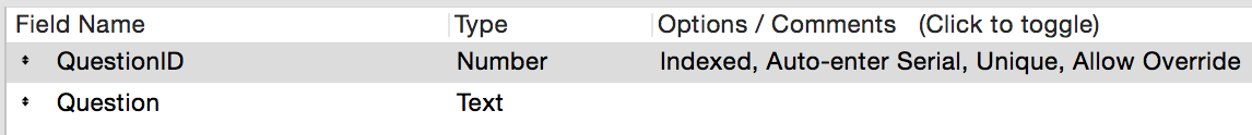

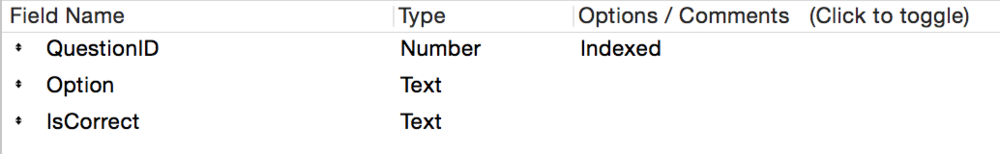

Ok, I've gone through this cool script line by line reading up on the commands used. I pasted the text into the global text field and ran the script but at first it only read the first question and options. I discovered that this was a newbie error causes by the weird way that the FileMaker Script editor does not allow direct text editing of scripts but forces users to put everything in click by click. This was the bad line I pasted in by mistake: Set Variable [ $i; Value:"Value:$i + 7"]. It should have read [ $i; Value:$i + 7].
I include the some details below for others noobs to be able to reproduce comment's great solution.

It turns out there's no space between the X and the option, so I adjusted the LEFT and RIGHT commands accordingly.
These are the commands I didn't know. Left takes 3 characters from the left of the $option text string. If that matches [X] $correct is set to 1. Right takes the full length of the string minus 3 characters from the right to not store the X in the option. The rest I couldn't come up with is clever looping using 2 counters $i and $j.

I found the bug and corrected it.

  1. The Options table should also have an auto-entered serial number OptionsID field~ as should every table (with the possible exception of the Globals table and such);
  2. The IsCorrect field should properly be a Number field; among other things, this will allow you to format it is as Boolean.
P.S. The looping is actually quite simple. Your file has a block of 7 lines for each question: the actual question, 5 options and a blank line. The outer loop starts at 1 and increments  by 7 on each iteration, so it always corresponds to a line containing the question. Then you just add 1, 2, 3, 4 and 5 to that to retrieve the options belonging to that question.
I will change the 2 points indicated. In fact, I was looking for a boolean format when I set up the variable but only found number format which didn't seem right.

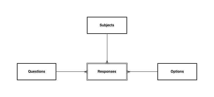

1 hour ago, LaRetta said:
I see three tables: Questions, Options and Responses
I see at least four:
This is assuming there is a single uniform questionnaire that all subjects must go through, once. Otherwise there would be more.
where the correct Option's response/s would be placed instead into the Responses table
I didn't quite get this part.
"where the correct Option's response/s would be placed instead into the Responses table."
Yes, that was poorly worded; thanks for the correction.  I just meant that the Subject's choice from Options (the OptionID) would go into the Responses table.  The word 'instead' was a typo which I had removed.  :-)
And yes indeed, Jax will want a Subjects table (user or person taking the test).
Edited by LaRetta
Thanks guys. I will add this at a later point. Just after looking up what a join table is ;).
