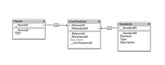

Heres a screenshot of my relationships.
See if this works for you (untested):
ExecuteSQL ( "SELECT Standard, Type ¶
FROM Certifications INNER JOIN Standards  ¶
ON Certifications.\"_fkStandardsID\" = Standards.\"__StandardsID\" ¶
WHERE Certifications.\"_fkParentID\" = ?";
__ParentID )
Yes this works If I add "/ to the values. Thank you so much!
