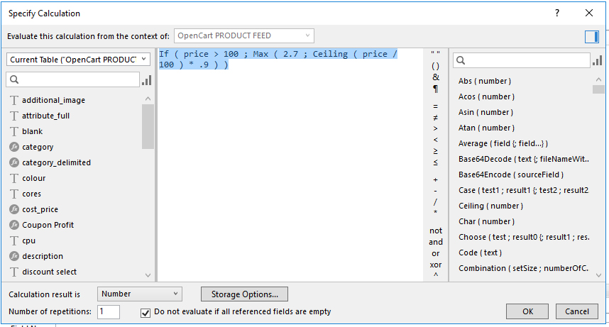

The calculation itself can be rather simple =
If ( Price > 100 ; Max ( 2.7 ; Ceiling ( Price / 100 ) * .9 ) )

Next, you want a minimum charge of 2.70, so the above becomes:
Finally, you only want to apply this to prices that are greater than 100:

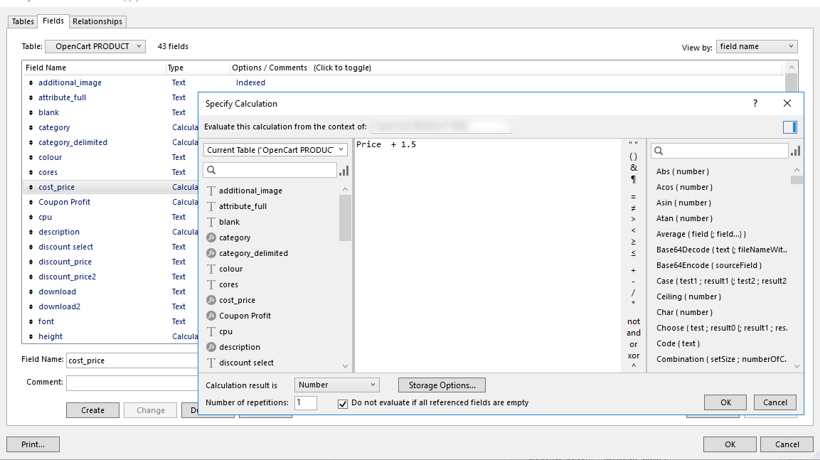

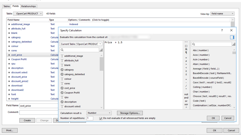

At the moment my Price field is a calculation field with: Price + 1.50 with output set as a number. (I use this calculation because the client has a ordering fee added to their actual cost on every order. So if their cost is 3.00 it actually becomes 4.50. As you can see in the attached screencap called Product Price Calculation... I created another field called insurance calculation and cut and paste your formula into and set the result to output as a number as you can see in the screencap called Insurance Calculation. Finally, I created a screencap called Insurance Compare...and you can see the two fields come out with very different numbers.
Hopefully not, as that would be a circular reference and nothing good would come out of it.

I just realized I left out an important piece of the puzzle. What I'm trying to do is create a system for a client to be able to import their product feed from their vendor, do some basic math functions on it and be able to export that field for their website import software with the correct field names...for instance the vendor calls their selling price just Price...the import program calls it cost_price. So there are actually two tables in the Db. One for the vendor's original imported fields and one for the website export fields and I just matched everything up to be exported correctly.
So my "price" field (website export field) is actually a calculation like this: Vendor Table::Price + 1.50
All i did was take the info from the Vendor Table and told it to add 1.50 (their vendor fee) and give me an actual price (for the website export).
From there I've taken the website export field "Price" and used it in the calculated insurance field which is set to be a number.
