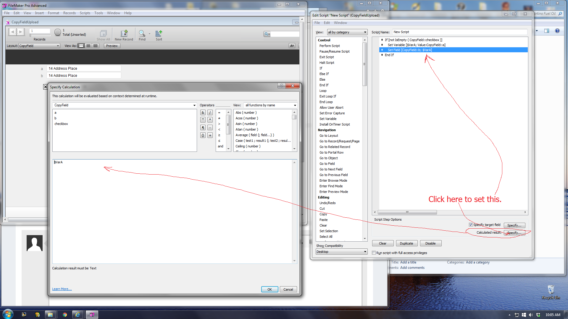

I have been trying to replicate this recommendation, could someone please show me where I am going wrong?

CopyFieldUpload.fmp12
Third line of script should read:
Set Field [CopyField::b; $VarA]
