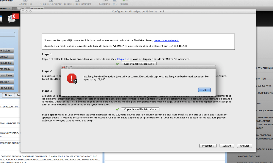

cannot complete install java runtime error
on mac mini server, fielmaker server 14 java 8 I can not go to the last step of the install. I've put the table, the scripts and the layout. After there is always the java runtime error and I can not go further. Can you help me ?

Please use the 'Send problem report' hyperlink on the MirrorSync launch page to send us the server log file.
done
I've tried another time (more than 10) and then it worked.
I had multiple error but been able to go.

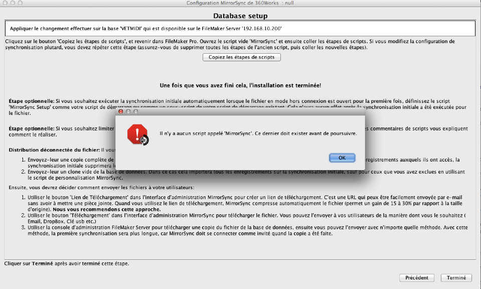

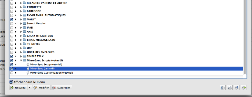

at the end there is this strange error telling me ther eis no script but there is the MirrorSync script.
cf printscreen
what to do ?

thanks a lot.
I do all the process again with this new file ?
Antoine
You shouldn't need to change anything in your FileMaker file. Just run the updater and then go through the configuration process. You can use all the same MirrorSync layouts and scripts that you already have.

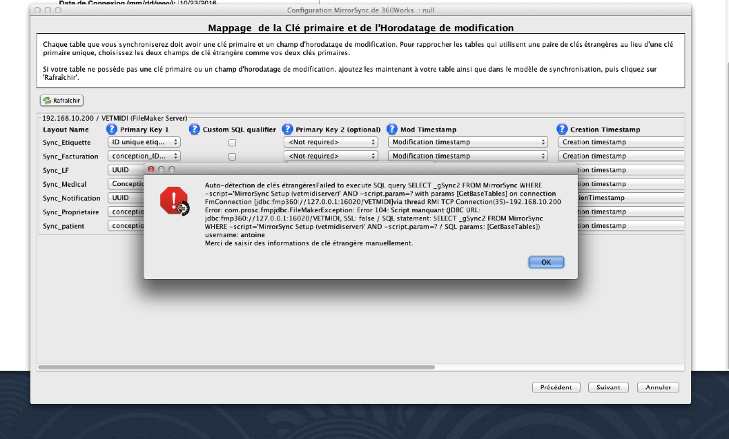

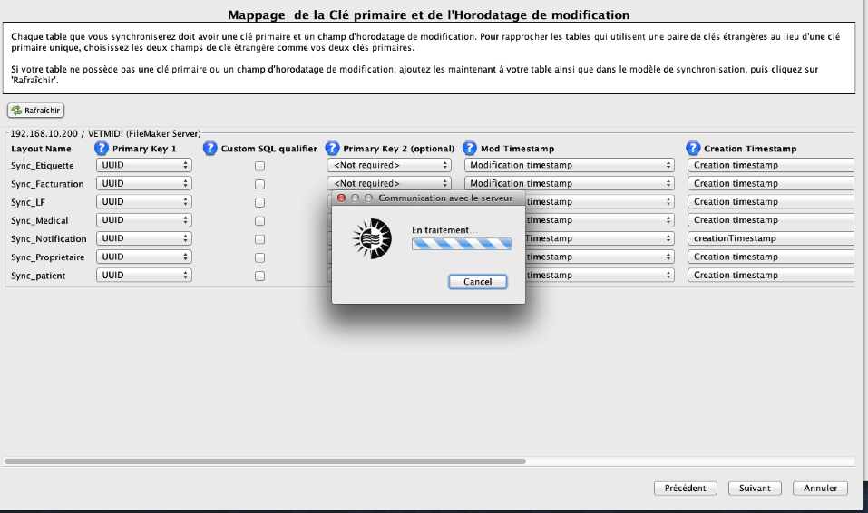

Sorry for that but it seems it's blocked for 15 minutes (2 times) on this screen.
Need to wait more ?

Send a problem report while it's still working on this screen.
I took a while and told me there is empty keys. I've corrected the rpoblem and it worked. Thanks for the support. I'm testing it now.

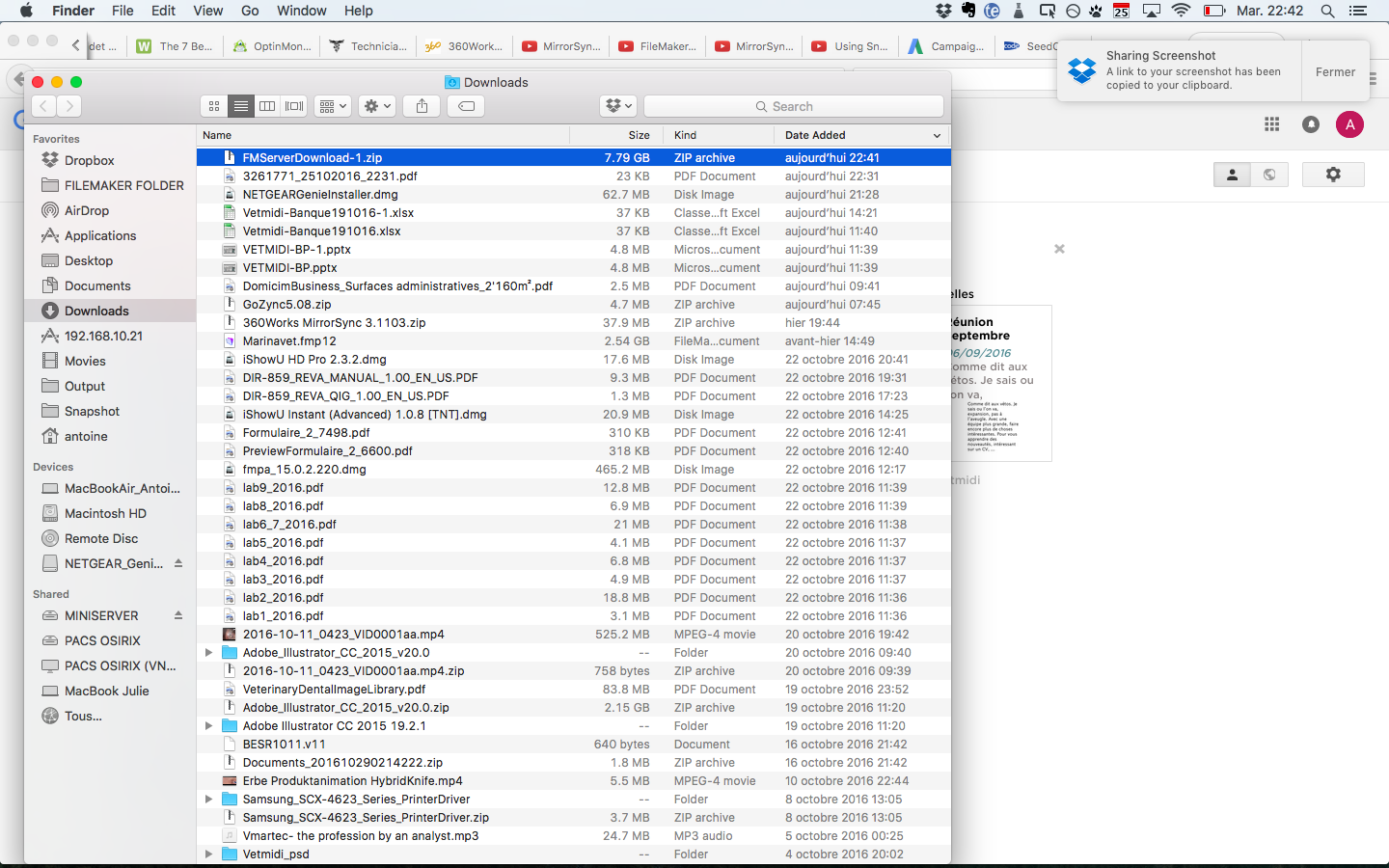

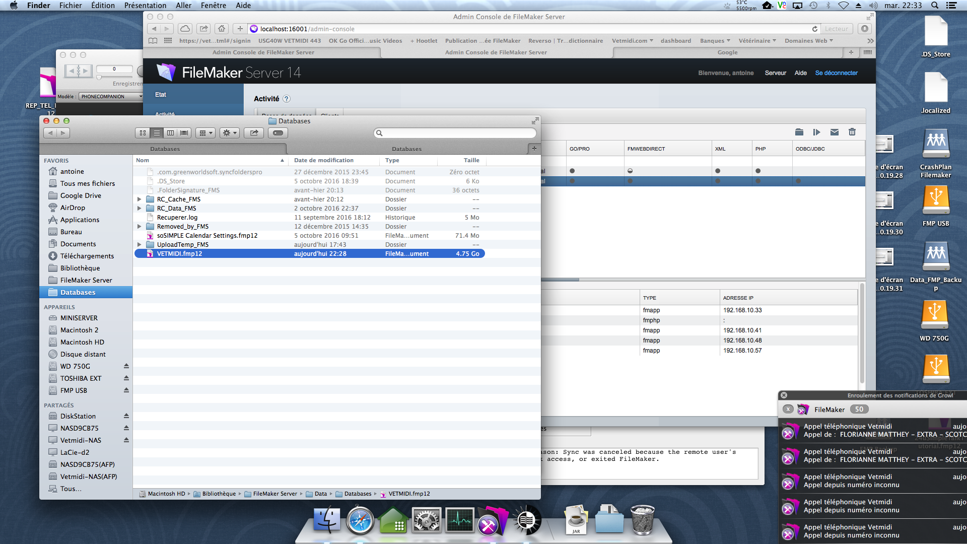

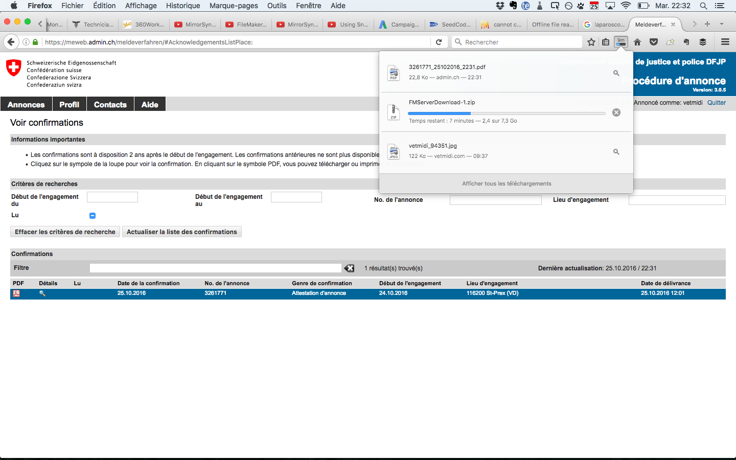

I'm sorry to ask you agasin this things but... After finishing the install, I've downloaded the file with the web brother. Instead of reducing the size the file became 7.5 Go (4.7 normaly) and the zip file was not opening with a header problem. So I took the file directly in the database (closed the file before). But when I sync, then problem it goes through all the records and wanted to delete 1000 of them ! So I stopped the sync.
Don't know exactly where it's wrong or what to do else to fix it.

first part of the post the file size, original one and the one generated via the link

error with the zip file downloaded

These screenshots are helpful for me to understand what the problem is, but they are not useful for actually seeing why the problem is happening. For that, I need the server log file.
The server logs reset every night at midnight, so please run the sync that is failing, so that it is the last thing in the log. Then use the 'Send problem report' hyperlink on the MirrorSync launch page to send us the server log file.
