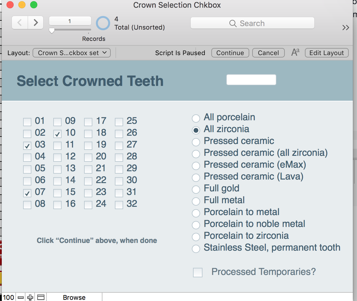

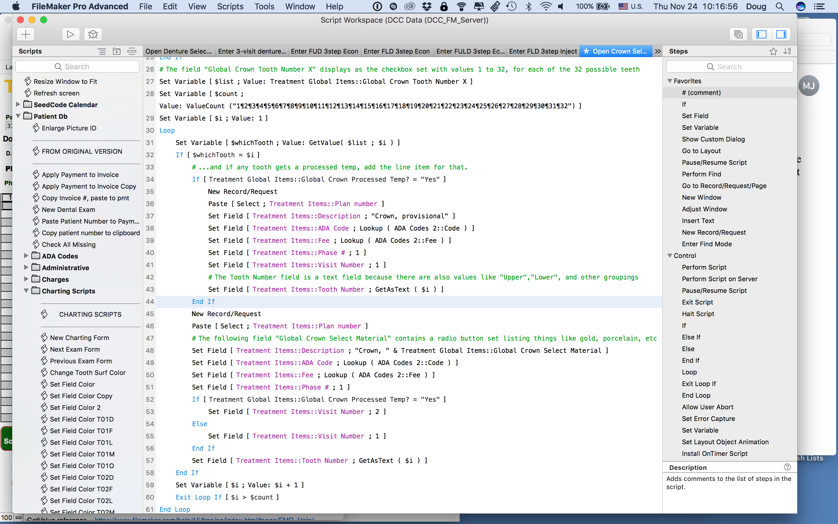

All right. I tried a number of iterations of your suggested script, but can't get the treatment line items which are tooth-number dependent to display on the treatment list. I'm attaching screen shots of both the Loop section with preceding Set Variable steps, and the window where the teeth and materials are selected. Here's how I interpreted it:
(I trust you'll let me know when the meter is running and I owe you a fee for helping me.)
Off top of my head - $count should be a count of how many items are in the $list - so, as I wrote it, not all the possible values
$whichTooth will be set to the current value depending on the position in the list (determined by $i) - so no need for the If statement
Have a look at those first - I'm about to finish up for the week, so if you're still having issues Sunday your time, post a zipped copy of the file here for people to look at...
Got it working now. Thanks so much for the insight. I will have lots more use for these script steps in future.
