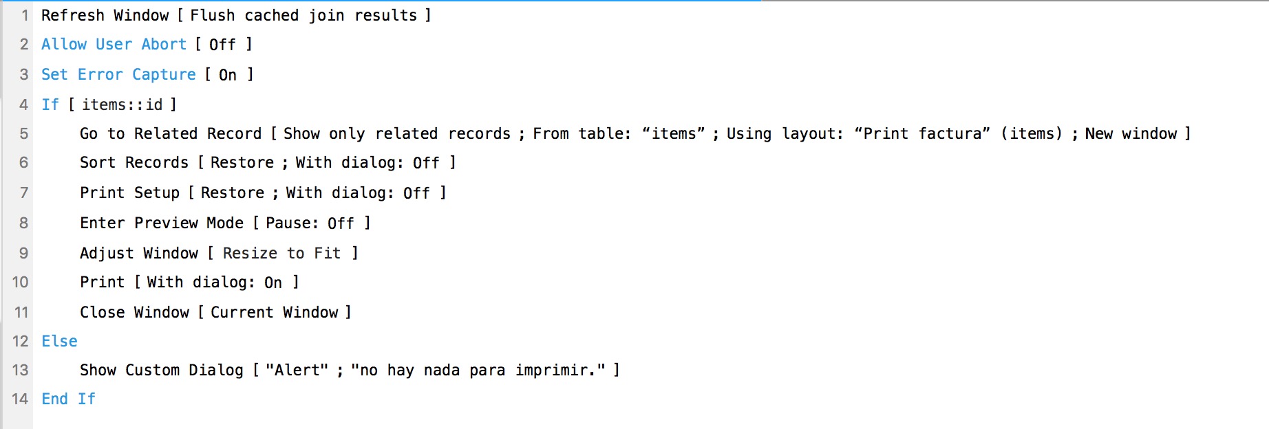

Hello , im having problem with filemaker when i try to print an invoice ... i usually press print button and then filemaker ask for printer and then prints,  but now  when i press "print" filemaker ask for printer and then it shows me the invoice in pdf.. it does not print .. i have to type command P to print that pdf.
here i attached my script steps
my script use to works fine but now i don't know whats happening.

Have you used Script Debugger and Data Viewer to see where it stop working?

Hello Lee Smith thanks for your reply
yes i test the script : in the line 10 it ask to choose printer then when i choose it i press print and instead of print it shows me a PDF mac preview.

Your Line 10 is set to Print to PDF - redo that script step from scratch.

Thank you !! It solves the problem
