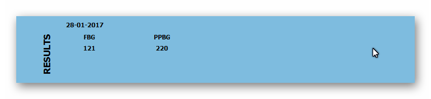

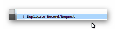

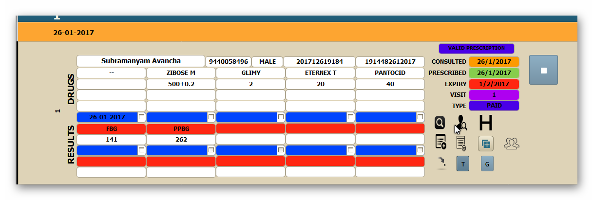

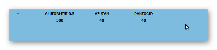

above image shows my patient record regarding previous prescription ..... i made button with plus sign above assigning duplicate record request ...... problem is when i am clicking button nxt record is showing like below ... showing me incomplete data
only few fileds data is visible why is this happening someone please help me thanks please :(

  patient prescription record

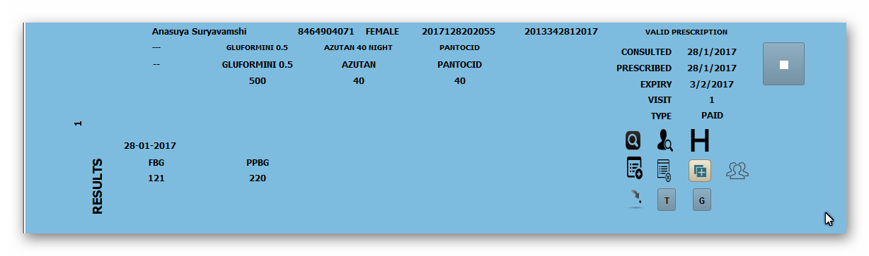

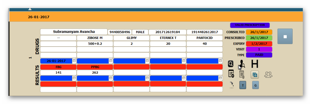

this pic 1 is related data from other table
this pic 2 is from same table
this pic 3 data from other table
this pic 4 from same table

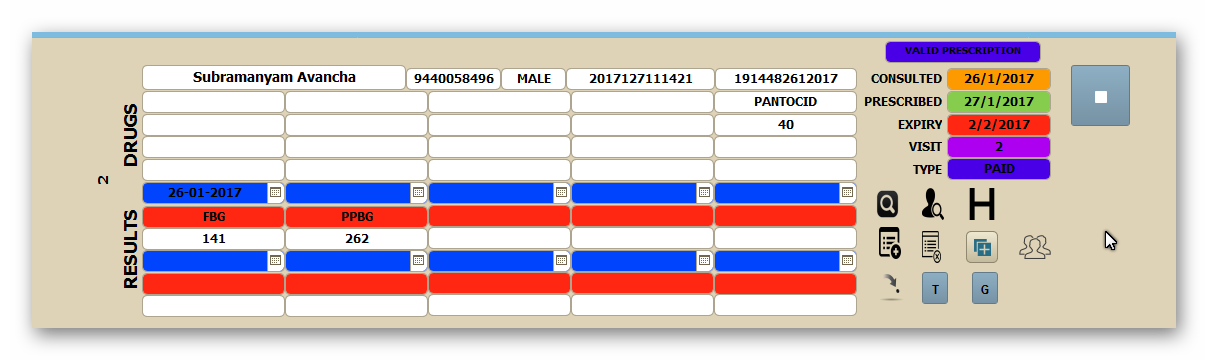

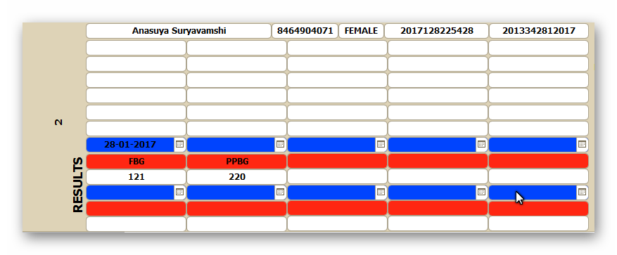

now i am duplicating pic is below
question is pic 1 & pic 4 data is getting copied when duplicated why not pic 2 and pic 3 is my question hope i am clear this tym
if i made mistake in making relationship the data wont appear right , so i am not understanding why ??
duplicating copies data from same table without problem then why not pic 2 isnt copied as it is from same table ??
