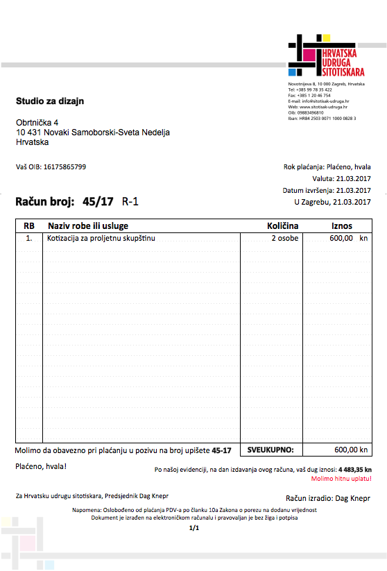

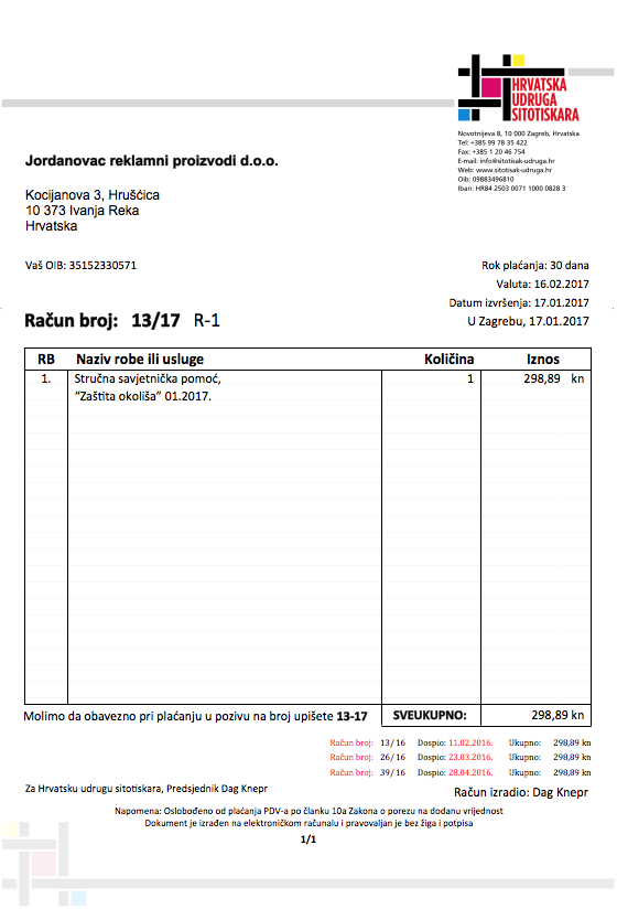

Ok, Screenshot 1 is how the invoice looks like, just to give you an idea of it.
You see the three red lines by the end, I made a portal here to show three or less invoices that are due. This works fine but can only fit so much.
Now I'd like to delete that portal and in its place put the sentence I talked about, with the total debt owed. To stress the problem further.

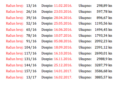

Screenshot 2 shows you a portal I made on the side, that has enough rows to show all the unpaid inovices. It has a summary that adds up to the total debt owed by the customer in the lower right corner. If I could make this summary total stay on one place somehow, I could use it for my purpose but it keeps moving since different clients have different number of unpaid invoices and I can't sort it to keep the total on top.
