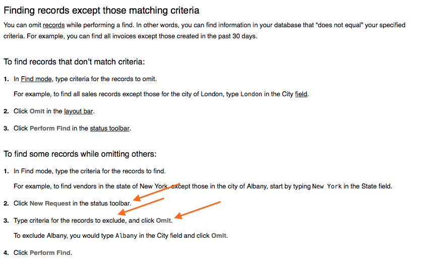

It sounds like you want to find some records and exclude certain ones from the results. See it this helps.
http://www.filemaker.com/help/15/fmp/en/#page/FMP_Help%2Fomitting-records.html
For example, to find vendors in the state of New York, except those in the city of Albany, start by typing New York in the State field.
2. Click New Request in the status toolbar.
3. Type criteria for the records to exclude, and click Omit.
To exclude Albany, you would type Albany in the City field and click Omit.
4. Click Perform Find.

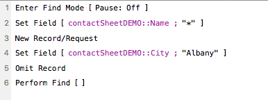

Yes, that is what I want to do  - BUT
1) I want to script it
2) the field names and entries to search on should be variable  - so basically using the Set Field by Name function to make the entry in the Find screen.  I just don't know how to turn that into an OMIT instead of Find.
Maybe exactly like it says.
New Record/Request
Set Field [ ........ ]
Omit Record/Request
Perform Find [ ]
