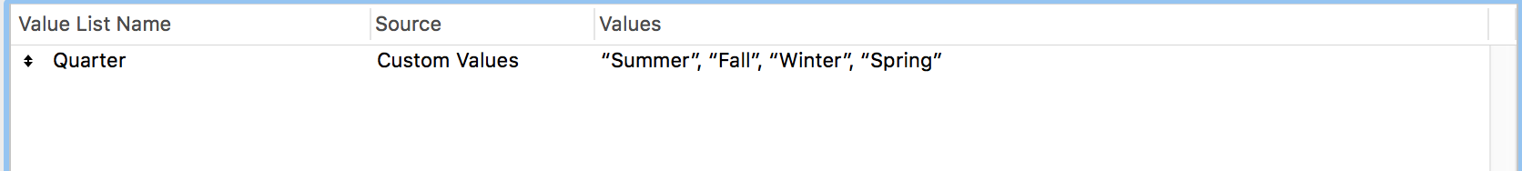

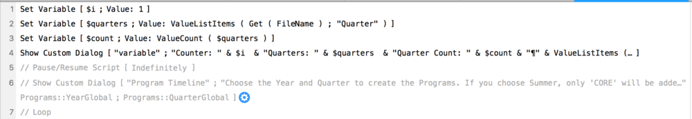

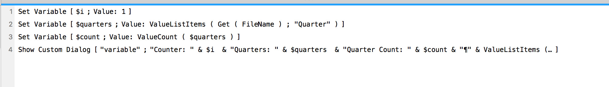

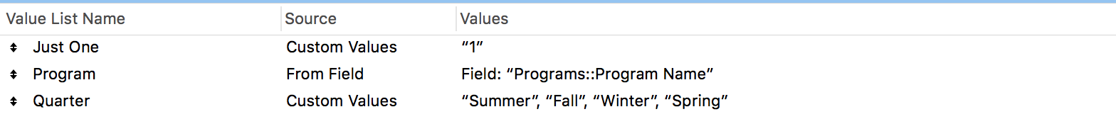

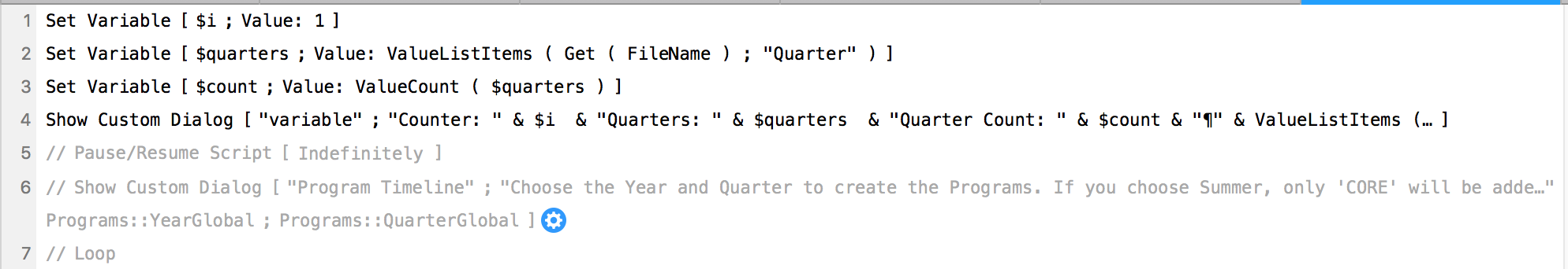

The top two images are a script and the Value List - part of the solution that I have been working with for some time. Everything is disabled after the steps I mentioned above and with the addition of a dialog box.
The bottom two images are a brand new solution with no fields or tables and with the script steps copied and pasted from my original solution. Script works in bottom, but not top

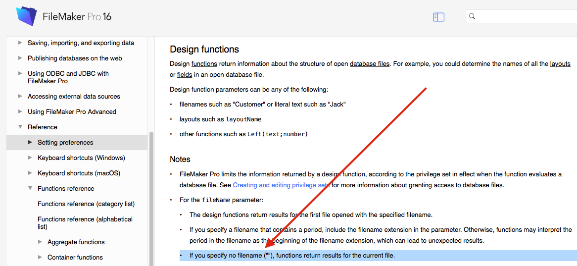

It IS documented; but the topic has been elevated appropriately within the help structure.
Look under the Notes section within the general Design Functions topic.
If you specify no filename (""), functions return results for the current file.
As mentioned.
That's what DOCUMENTED means.
