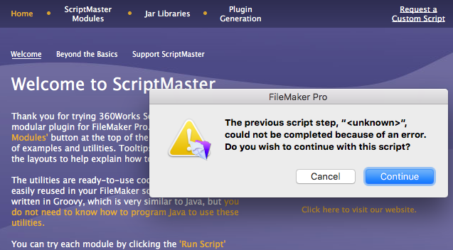

Running any implemented script shows info: The previous script step, "<unknown>", could not be completed because of error. Do you wish to continue with this script? with Cancel and Continue buttons.
When clicking Continue in open Script Debugger are visible few lines with steps "<unknown> [ NOT IMPLEMENTED]" in "Run script" script. After clicking Continue 2 times script ends, but do nothing.

In version 5.0.3 the same error just after opening ScriptMaster.fmp12 file. Screenshot attached.
Marek.
