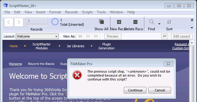

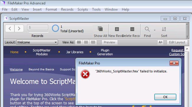

I seem unable to load Script master in FMPA 16 (32 bit) on Windows 7 32 and on Windows 10 64. My solution must be 32 bit.

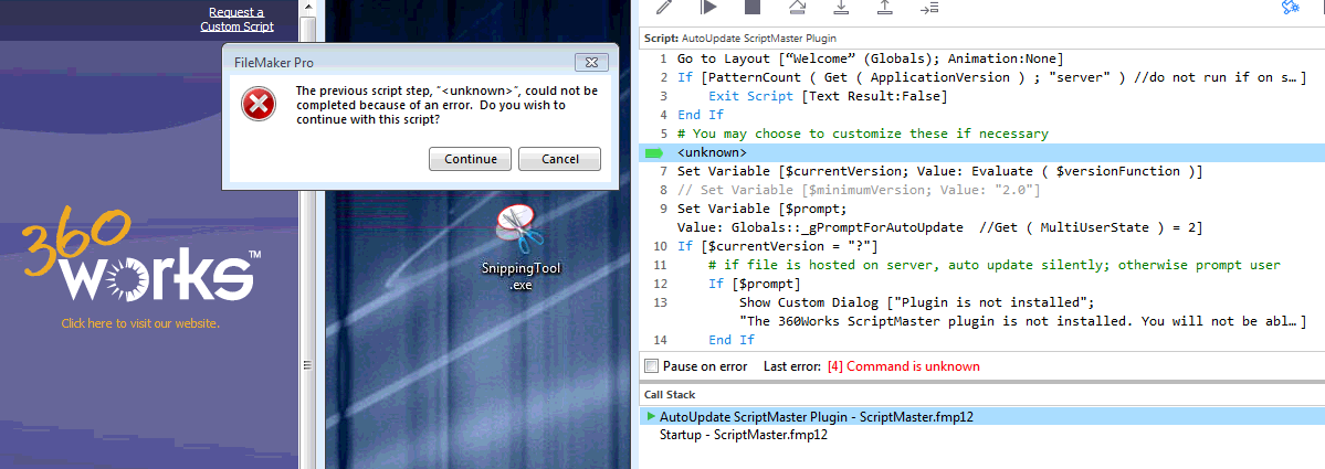

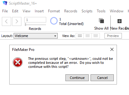

Plugin was placed in the extensions folder. There are unknown script steps in it startup script.
Any advice please ?

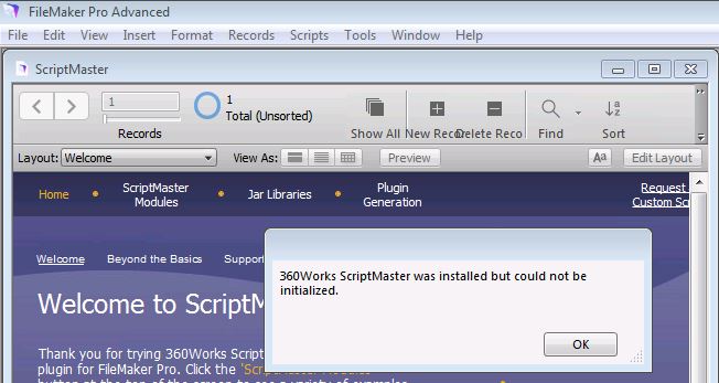

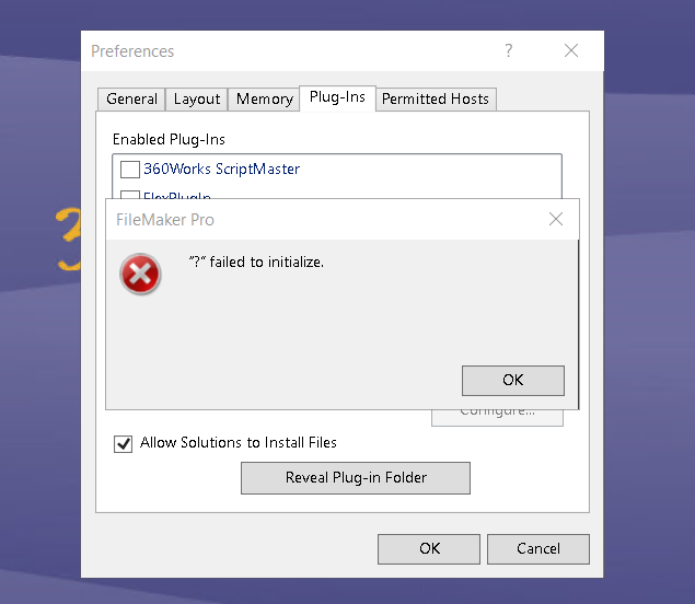

I have same issue. Plugin failed to initialize. Problem is also with FileMaker Server 16 on Windows Server 2008 r2.

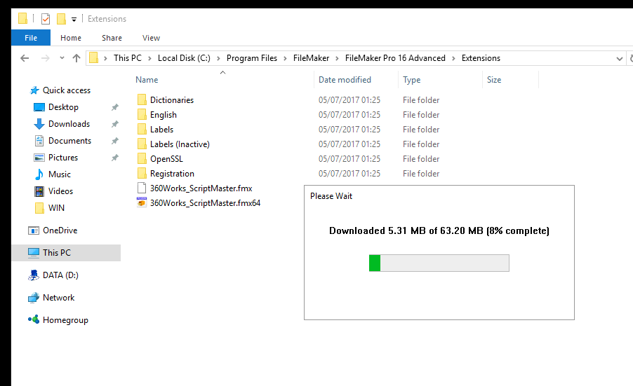

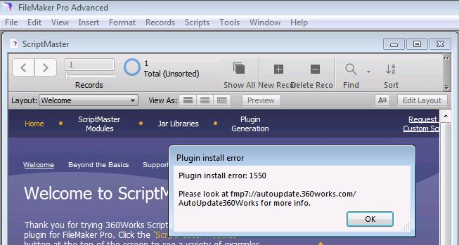

FYI on the very first try on any old or new fresh machine, there is a download that takes place, but even after that, FMPA 16 (32) just says plugin is not installed.
What is it downloading and where is it going ?
It is istalled off-course. I noticed however that on Win 7 (64) The FMPA 15 (32) installs the plugin into the wrong folder, i.e. Program Files .... not Program Files (X86)

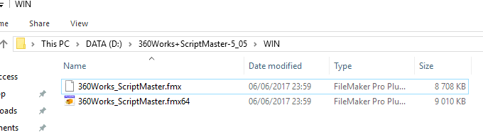

On any platform, the .fmx icon does not seem right, compared to the .fmx64.

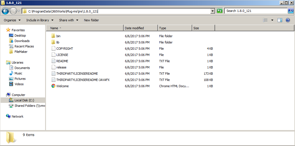

Our plugins are written in Java so while we have removed the requirement for Java to be installed,  a Java runtime environment is still required in order for the code to execute. The download you are seeing is downloading a JRE and saving it at C:\ProgramData\360Works\Plug-ins\jre .  The Java is run as an executable and is not installed on the machine.
With that being said, I believe the issues you are seeing is because the JRE that is getting downloaded is 64-bit. To remedy this,  please download this build of ScriptMaster and install it. Next, delete the "1.8.0_121" folder at C:\ProgramData\360Works\Plug-ins\jre\1.8.0_121.  Next, download this file and extract it. Once extracted, place the “1.8.0_121” folder in place of the one you deleted so that the path is C:\ProgramData\360Works\Plug-ins\jre\1.8.0_121. Please see the attached screen shot to confirm that you have everything in the correct place. Once you have done that, launch FileMaker and check in Edit->Preferences->Plugins that it is checked as enabled. You may need to check it to enable it.

Running ScriptMaster 16+.fmp12 from FMS16 (Mac) FileMaker 16 (32 or 64) will fail at first, but one has to to enable the plug-in in preferences every time,
then re-run Startup Script then it works for either 32 or 64)
