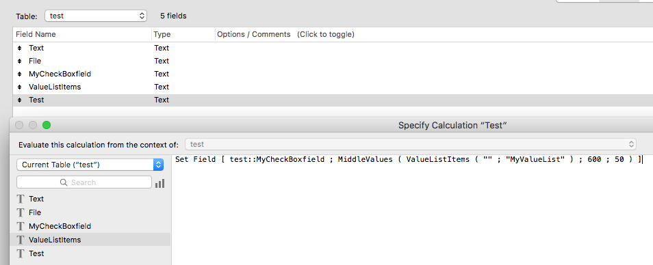

I tested this and got a "The specified field cannot be found".  "Set Field" was highlighted.  *Sigh*
You must replace the table/field names with YOUR table/field names (easy to select them from drop-down).  Also be sure to match YOUR value list name precisely.
