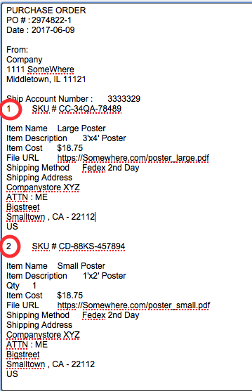

My issue  is I need to create a loop and be able to break out each Line Number for it's own record.. In this example text there are two line numbers.
Trying to grab  SKU #, Item Name, Item Description, Item Cost, File URL
Any help would be greatly appreciated!!

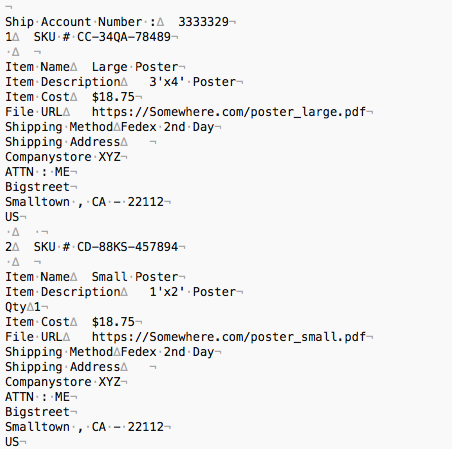

Thanks Comment..
I was able to extract SKU info after making sure that Return Characters, Tabs and Spacing were correct.
But I've been unable to grab anything else.
I'm supplying a screen shot to show returns and tabs.
Let ( [
start = Position ( $e_mail ; "¶File URL	" ; 1 ; $n ) + 6 ;
end = Position ( $e_mail ; "¶Shipping " ; 1 ; $n )
Middle ( $e_mail ; start ; end - start )

It seems to work just fine for me - even better if I change the + 6 to +10 (the length of the start search string). Please post a zipped text file instead of a screenshot.

We only have one small example of the input and no clear formulation of the rules. Do you know what the numbers just before the string "SKU #" represent?
sorry. should have explained that part more...The shipping address it the part below the Shipping Method for each SKU  (Line Item)
