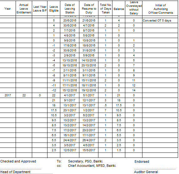

I need help in printing. So I have a portal that I setup like a spreadsheet with rows and columns and a scroll bar.
New entries to the portal will of-course jump to the new row until the portal window is full and then a scroll bar down for new entries. My problem is that I setup the print option to print the preview of the portal but then it will only show the top full visible part of the portal but I want it to scroll to the bottom of the portal and then print that preview part instead but if I manually scroll down and then print...it will always print as if I didn't scroll down the rows.
Any suggestions please?
Portals are not meant for printing. Print from a list layout of the child table instead.
Thanks...actually I am not printing the portal but the preview of the portal as in "print preview" but I need to print preview the portal that shows the last rows which are not shown unless you scroll down to the bottom of the portal.

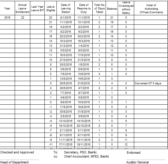

I am attaching 2 pics for clarification.
the 1st picture is what happens when I print (since the print option uses the print preview view) but I need it to be like in the second picture, the portal has been scrolled down to the bottom and then Print that print preview.
I noticed that the print preview always shows the top rows. Is there a way around this?
I am afraid I don't see the difference. Print preview shows you what will be printed. Filemaker does not print (or preview) a screenshot. It renders the layout specially for printing - and your current position in a portal will be ignored. There is no way to "pre-scroll" a portal for printing (unless you want to capture a screenshot and print that).

The form above should be printed in that table format as a requirement for my work. Right now I do a screenshot of the portal just like the one I uploaded and then do some photo editing and then print. It's a lot of work and it would be nice to just click a button and do just that. Can FM do a screenshot script and cropping of images? lol
If you based your layout on the portal table, then your layout would be in list view, and can look exactly like that.
O don't see any summaries, so if you want to show the last 25 lines, do a find, or omit the records you don't want to show, then print.
