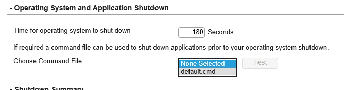

hello Wim i was checking my UPS console and it has an option to insert a command that shutdown aplications before shutting down the operating system
my question is how to write a command that close the databases in Filemaker Server??

596d39ed5cd42_ScreenShot2017-07-17at5_22_04PM.thumb.jpg.6bf61feda71e43677a6ef88be801b6b4.jpg
How to run an OS-level script depends on the UPS software.  The screenshot above would point to something that is not sufficient. You don't want it to run a command before shutting down the OS because that is still a chain of events that you have no control over.  The ideal situation is the ability to run an OS-level script that you can run when the UPS goes on battery power and long before it would even attempt to shut down the machine.
If the UPS for instance can deliver 15 minutes of battery power you'd set it up so that it closes the FMS files after 5 minutes.  Giving it ample time to disconnect ghost users (unless the users are also on UPS and so are all the network switches, all users will be ghost users to FMS, FMS will try to ping them but they won't respond so FMS will want to wait the usual 2 minutes).
