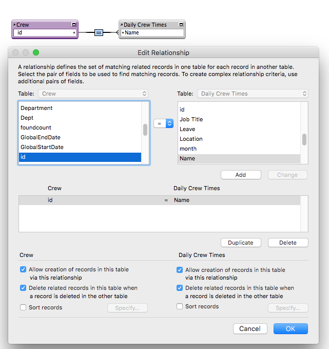

You were close. Your relationship is based on the relationship of Daily Crew Times but the Portal is using the current table and not the relationship.

I'll attach a screenshot in a couple of min to show the relationship

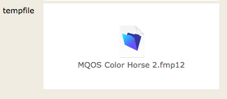

One issue with file size is the global container field, 20MB, a FileMaker file MQOS Color Horse 2.fmp12

Thanks Bruce....
Lee I did as Bruce found so it is down to 57.. I did the recovery . It came up with the recovery log but was still at the larger size so gonna investigate further!
That a Girl. Let us know what you find.
Created a clone, cleared the container field, imported data into the clone.
762kb.

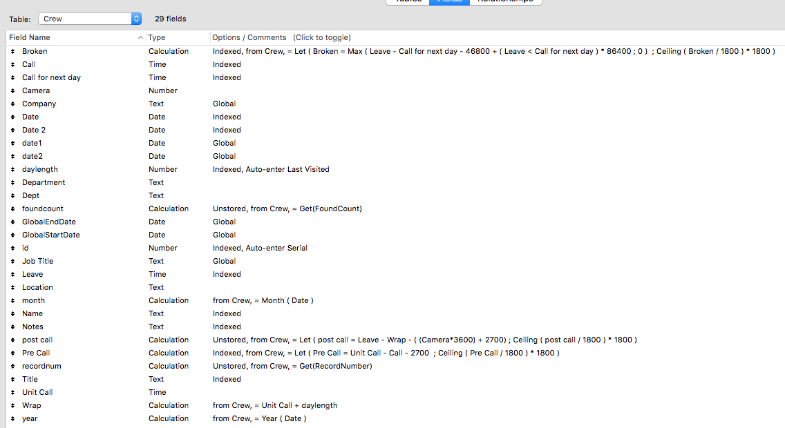

A "delete everything" relationship when you delete any record is NOT a good idea.
The file has serious design problems, you need a proper table structure.
The field list hints at what you're trying to do but it's a mess.
Find a qualified developer. (Not volunteering)

Yes a mess I know, but this is me learning and teaching myself so always try to have a go first to see if I can figure it out and learn as I go... so your advice is apprecitated. going to see if I can tidy it up myself first. thanks Sarah
