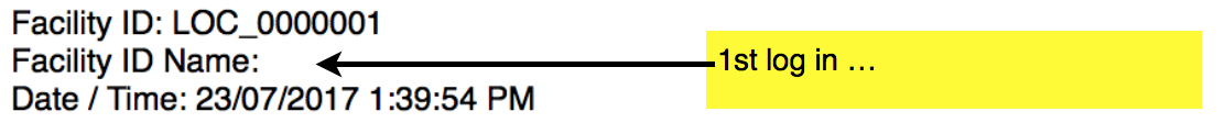

I've attached a pic of the global field that I am currently trying to figure out what is going on.  When I log in ( USA ), this fields writes every time ... however, when my user logs in ( Dubai ) ... it doesn't ?  It takes several attempts ????? Any Ideas.
