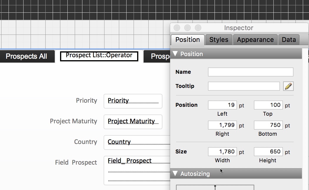

In the attached file in BD Demo, in layout Prospects All and Tab *Prospects All*. I have tried to follow an existing script, so when you you applied a *Filter* you can then click on the Side Button which should then take you to the next Tab, which will present the information based on that entry, in the respective tags.

You did not name your tab in the Inspector, and then substitute that name for "Tab Name" in the script.
Hi Doug,
Thank You very much, that now works as intended, I knew it was something simple.
Regards,
Kevin
