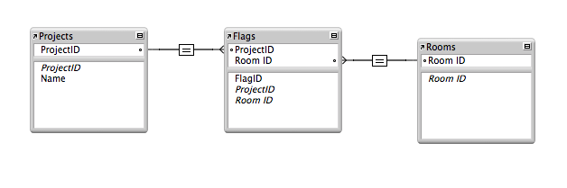

You need three tables if you want a proper many-to-many relationship between Projects and Rooms. But then the third table needs to be a join table between the other two:

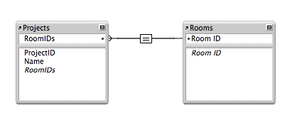

If you just want a quick way to assign rooms to a project - with no ability to records anything about a specific assignment and limited reporting capabilities - you can settle for just two tables:
where Projects::RoomIDs would be a checkbox using values from Rooms:RooomID.
