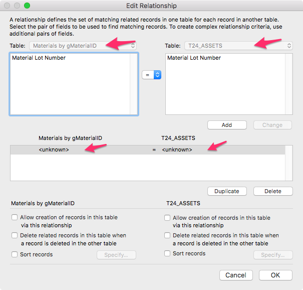

Material 1 is using or relying on a related table for the number (table not included)
Whereas, Material 2 is not using a related table.

I can't find  the Custom Function by raybaudi that your using.
Check out the relationships, you are trying to use data from a non -  existing table and relationship.

This is part of the problem.
I saw the Custom Function you have before I asked the question. I wanted to see the source of this CF,  to  see if I could pick what you're missing..
I have several of Raybaundi's calculations and custom functions, but I don't have this one.
