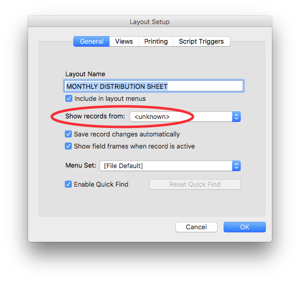

There is nothing wrong with the merge expression.
The text block in question is actually a GROUP; and part of the group is an invalid field.
Apparently you had another TO of one of the tables that you have since deleted - but you did not reassign the layouts and the fields belonging to that TO to another occurrence of the same table.
True; and also ...
Layout #5 has the correct table occurrence but still shows the problem, due to the other issue (invalid field ref).
And once the table occurrence for layout MONTHLY DISTRIBUTION SHEET is straightened out, the problem still exists on that layout; because of the bad field ref.
[edited]
Edited by BruceR
replies supplement each other
It's the same issue: some layouts and some fields are assigned to a deleted TO. My post was intended to add to your answer, not to contradict it.

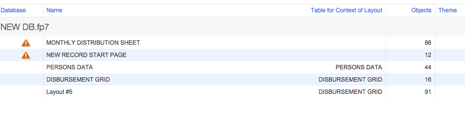

Hi John,
Bruce and comment responded with more or less the same things I was about to say.
It might help to see this screenshot of your  TOs and Layouts.
HTH
