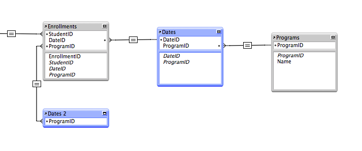

If a Program has several instances (what you call Dates), and a Student enrolls into a specific instance of a Program, then obviously your basic TOG should look like this:
Students --< Enrollments >-- Dates >-- Programs
In order to pick the Program first, then the Date, define an auxiliary relationship as:
Enrollments::ProgramID = Dates 2::ProgramID
and use it to create a value list of related DateIDs, starting from Enrollments.

41 minutes ago, muskee said:
On which field should the value list be on? I
The second value list should be attached to the Enrollments::DateID field, which is the matchfield to Dates.
I currently select the program ID and then select the dates but I don't get the information accordingly
Make sure you get your information from Dates, not Dates 2.
You mean like this?
No, I mean like this:
Thanks guys, solved my problem!
