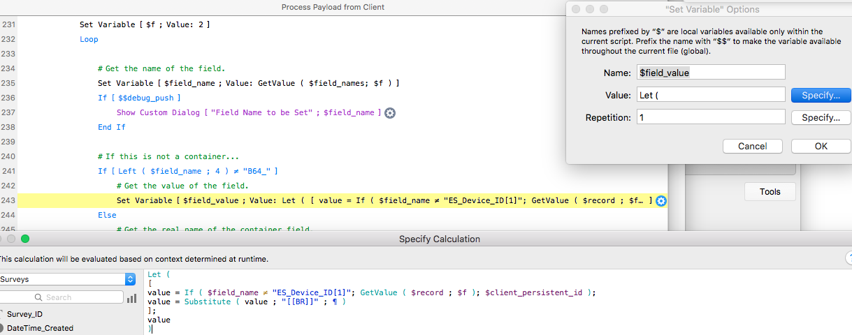

Here's my understanding. The $script_override is used during a pull to keep ES_UTC and ES_Device_ID from auto-entering on the local file, so that's fine. And ES_Device_ID should also not auto-enter on the server and should be set the same as that in the pushed record. Tim originally scripted it to do that by sneaking this in in the middle of 'Process Payload from Client':
59adf486e7763_ScreenShot2017-09-04at5_48_52PM.thumb.png.ecd5b37870b3fa0a6acf0a427c28cef5.png
The calc shows that instead of letting ES_Device_ID update by itself with the server's id, it uses $client_persistent_id, which comes from the script parameter. In summation: $script override prevents auto-enter while the field is manually written. All good so far.
