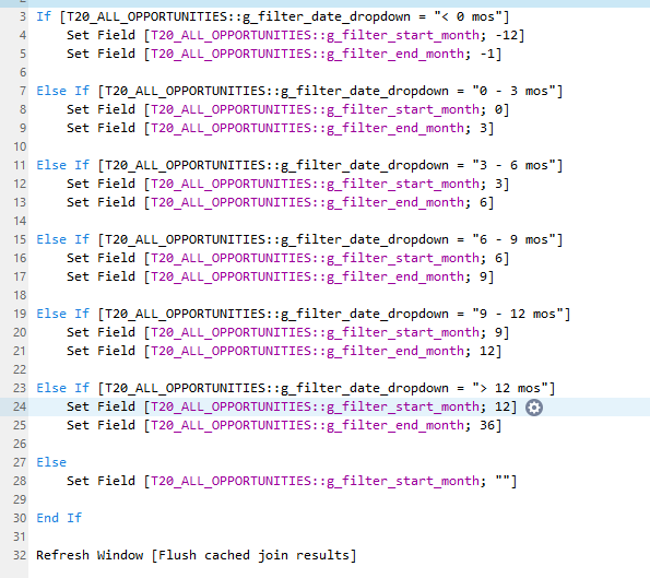

Thanks for the expression it worked great, only had to had a plus 1 to the end date to include last month. To extract the month numbers just created a dropdown with the selection list, then a script with if statements to set the Start/End fields that are used in your expression. Thanks again.
You can use Case() statements within the filtering expression itself instead.
I will give that a try, is there an advantage to using the case statements in the portal?
You save 2 global fields, a script and a script trigger.
