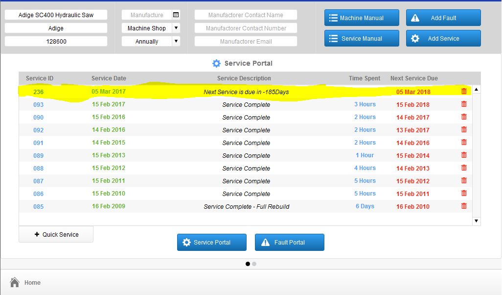

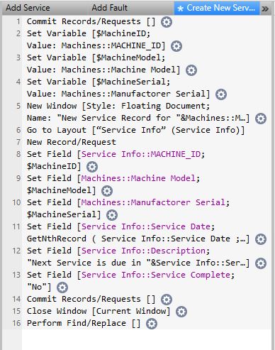

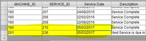

I am designing a database for out maintenance guys. I have a table called "Machines", this contains all the machines we have with serial details etc, I then have another table called "Service Info", these are linked with a primary key called MachineID. On my machines form layout is a portal that shows all the services for that particular machine. I want to create a script that adds a service file for that particular machine and copies over the last service date, how ever what I tried doesnt work because it take the last record within the whole of the service info table and uses that, in otherwords it copying another machines service date. This is the script.

Assuming the portal on your MACHINE layout is sorted with the most recent service at the top, then you could set some another variable (before the 'New Window' step) to capture the last service date by doing something like :-
Go To Field ("Any field in your portal")
Go To Portal Row (First)
Set Variable ($lastServiceDate , <lastServiceFieldname>)
This should be simple and work fine. You could also use an execute SQL statement to get the most recent service date, replace the three lines above with something like :-
ExecuteSQL ("
SELECT lastServiceDate
FROM ServiceInfo
WHERE MACHINE_ID = ?
ORDER BY lastServiceDate DESC
FETCH FIRST 1 ROW ONLY" ; "" ; "" ; Machines::MACHINE_ID)
