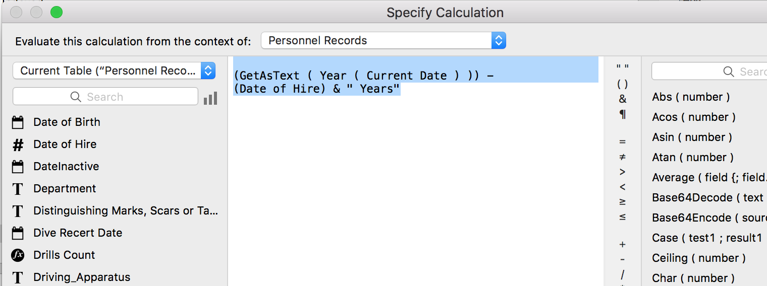

I have a ton of calculations in my Fire Dept database yet I can't seem to get this simple one to return what i expect.
I have a "Date of Hire" field with a year in it.  I am trying to have a calculation field return a simple year.  ie. 12 years.
I had found the calculation here in the forum for the calculation result of XX Years, XX Months, XX Days but that doesn't work when the fire dept only enters a year of hire instead of a full date.
Here is what I was trying to use.
Thanks in advance for all your time!
Chris
( year( get( currentdate)) - Date of Hire) & " Years"
