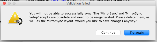

Hi There,
In the setup procedure we are getting this message over and over.
When we continue it seems to work fine ? What to do ? Is it safe to use ?5a339e6c7c078_ScreenShot2017-12-15at10_24_14.png.c1aa648c4f00acd7943409d72a4943da.png
What version of MirrorSync are you running?
Version  4.0, build 9400
Please try with this version to see if it fixes the problem. If it does not, then go to the MirrorSync launch page in your browser and click the 'send problem report and log files' link, so that we can review the MirrorSync log file.
