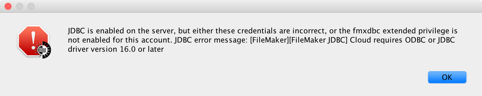

Error - filemaker mirrorsync jdbc error cloud requires version 16.0 or later

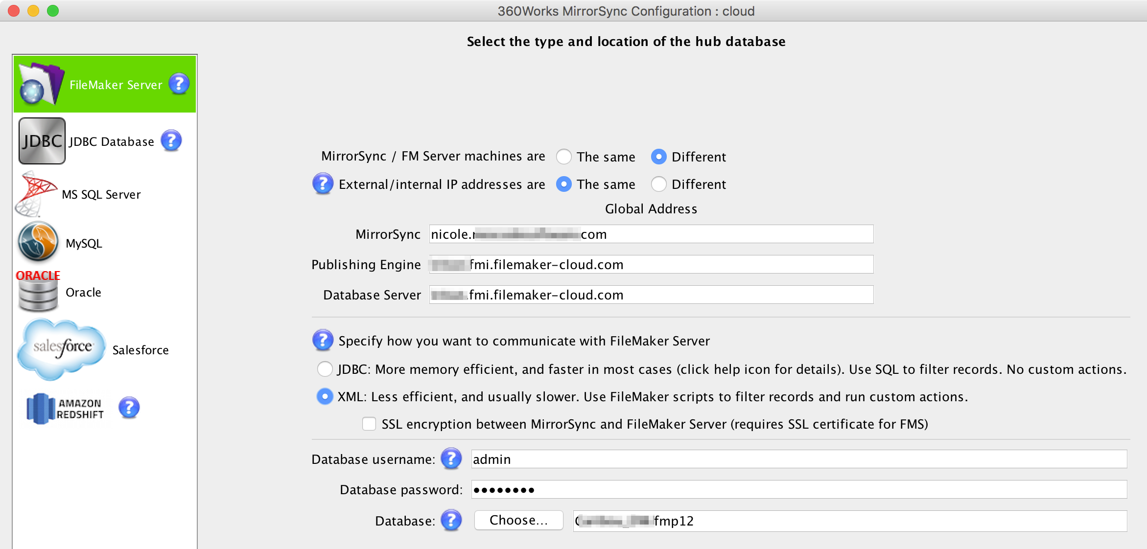

2. create filemaker client to server config
3. configure mirrorsync to use hosted version
4. configure publishing engine / database server to use cloud
5. put any database user, pass or name - it doesn't matter what you put - real or not real
6. you will error -  filemaker mirrorsync jdbc error cloud requires version 16.0 or later
Also tried MirrorSync 4.0 on a FileMaker 16 host - same error message
Jesse - awesome! This is confirmed working. Thank you!
