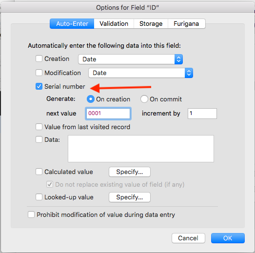

Which Serial are you referring to, this one?
Assuming your database is set up properly, and your serial number field has the proper validations, specifically On create, you can do this..

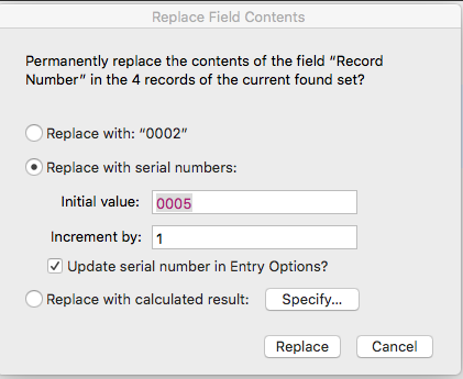

Making sure you clicked the serial field with a found set of records that have no serial number in them, Select into the top menu item "Records", then Replace Field Contents...
The second radio button "Replace with serial numbers and choose a starting number and an increment.

Yes.  The screen shot you posted is what I am using, yes.

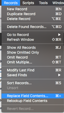

Here are the steps,
In Browse Mode.
Show all record,
Go to the first record
Put your curser in the Serial Number field
hit CMD + = or go to the Menu and select
See Replace png
and then fill in the Replace Field Content,
Be to put in the first value (i.e. "1")
Be sure you do this carefully i.e. the right field, because you can't undo this.
