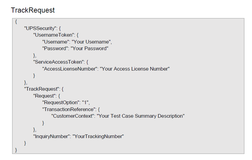

The format of my XML appears to match the JSON example from their documentation, other than the order of objects (FileMaker seems to list them in alphabetical order), but I don't think that matters.

This is what the documentation shows:
