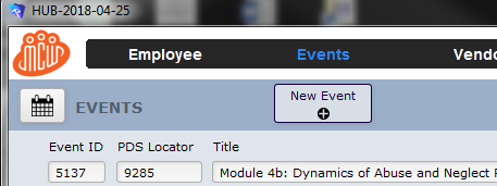

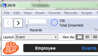

The main toolbar with the arrows for navigating from record to record, find, etc. disappears.  I removed the toolbar from a few windows that are controlled by buttons - to add related records, but the main window should have the toolbar.  I have to recover the file to get them back and when I close the file they disappear again.  I can't figure out how to fix this.

Ctrl + Alt +S toggles the toolbar, so no need to recover.
