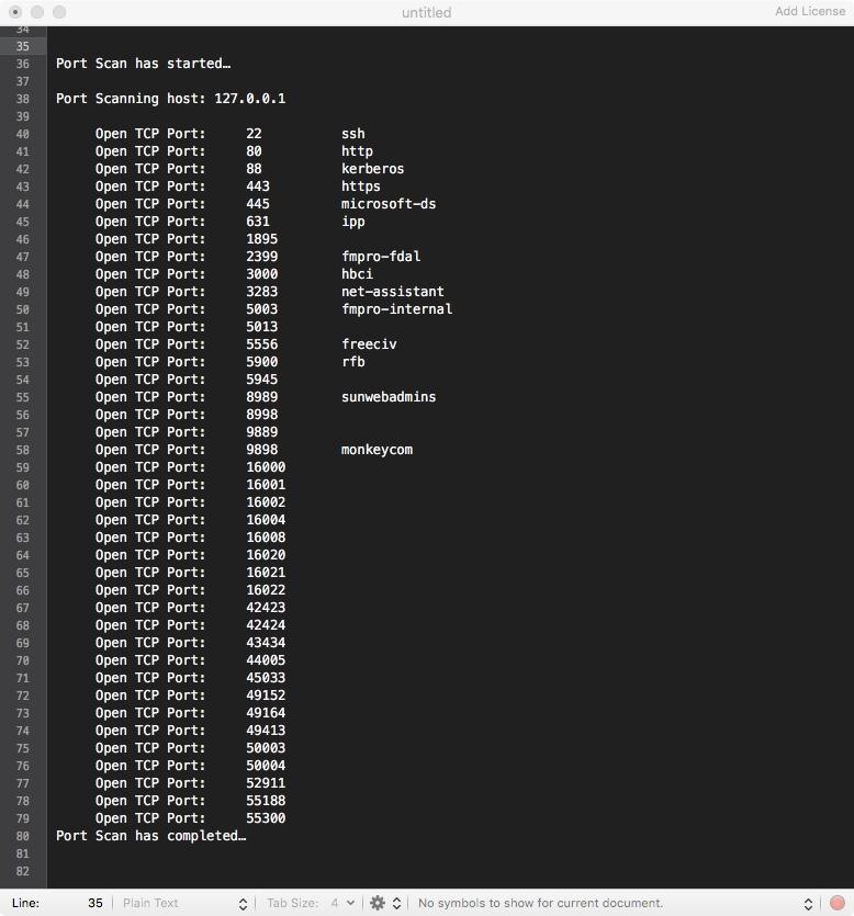

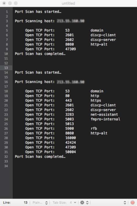

Furthermore, I did a port scan locally and from outside the local network.  What's weird and what I can't figure out is that the ports that are open are not the same.  The shorter list of open ports is what's open locally.

Thanks for you reply.  nslookup gives my correct ip address.  So there are no problems there.  I did a port scan of localhost a got the results posted below.  When you say
Quote
 you are trying to access your filemaker server with an external ip address when using dns
that is precisely what I want to do.  I need to be able to test WebDirect on my own computer so that I know it's working for different users.
I have posted below the results I get when I do a port scan for localhost.  It seems to me that the necessary ports are open both externally and internally.  So why isn't it working?
