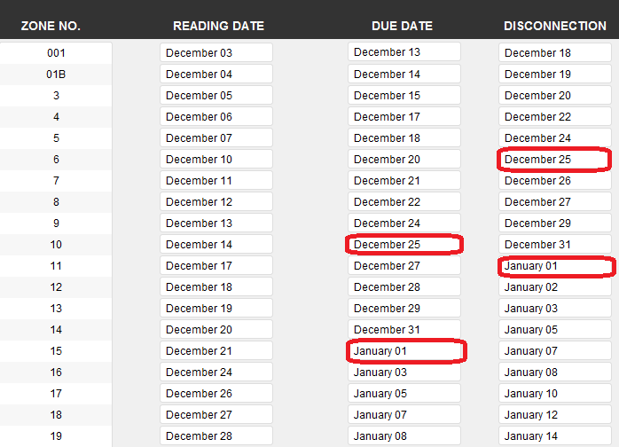

I really need your help guys. I couldn't solve this problem. Currently I'm making a solution about Meter Reading Schedule.
My problem is, I couldn't skip these dates November 1, December 25, and January 1. What I want is to skip those dates. My Reading Date column works great. I don't have problem of it. The problem is my Due Date and Disconnection Date column.
Here's the sample calculation of my Due Date:

How are the fields being populated in the first place?  Is the reading date entered manually, then due date and disconnect date calculated?
It also looks like you can't have a due date on a Sunday, so you switch it to Monday.
And you don't want a due date, or a disconnection to fall on a blackout date.
Are those assumptions correct?
If that's your exact calculation there is one technical problem with it.  After you declare your last variable, there should not be a ; (semi colon like all the other variables)  just a ]; (bracket then semi colon).
Other than that, you don't really say how the script fails.  Did you try breaking it down to smaller chunks and watching it with the script debugger and data viewer?

Thanks for effort Steve. I really appreciate it. I will download your work now and gonna try it. I'll get back to you about this. Thank you Steve!
Hello Steve, good afternoon.
Your calculations works great. Two thumbs for you man. However, I need your help again guys.

If your original screenshot is from Dec 2018, then it appears the selected reading dates are from Monday to Friday.  Do you only take readings from M-F unless one of those days is a blackout date?

Currently, I'm making a solution for a government agency here in our country and one of this is the Reading Schedule. And up to now there are still using MS Excel for the Reading Schedule and they input it manually. Although they are using MS Excel like what I've said they are still input those Reading Dates, Due Dates, and Disconnection Dates MANUALLY. There are 36 zones and every zone there are about 200 to 600 concessionaires approximately. So, there are 9,500 concessionaires approximately.
Quote
I don't understand what you mean by "...when I set the Reading field in the Reading column..." unless it refers back to my first comment.
As you can see the video below, there are four columns. Column for Zone Numbers, column for Reading Dates, column for Due Dates, and column for Disconnection Dates. What their office wanted to happen is, they want to set only one date for the Reading Date column then the rest will automatically be calculated (See the video below). The first date that I set on the top is the Billing Month consumption. The second date that I set, that's the first field for Reading Date. So, when I set the date of the first field of the Reading Date, the rest of fields will automatically calculated. That's what they wanted to happen Steve.
