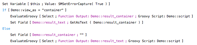

If you are using FileMaker 17, please download the latest developer build of ScriptMaster from the link below.
http://sc.360works.com/SuperContainer/RawData/pro/360/plugins/scriptmaster/latest
I was not able to reproduce the crash behavior you're seeing with this build. After calling SMSetErrorCapture(true), I did not receive anymore error dialogs for the remainder of my session, and I produced an error 10+ times in a row. I tested in FileMaker Pro Advanced 17.0.3.304 on Mac High Sierra 10.13.5, using jre 9.0.1.
