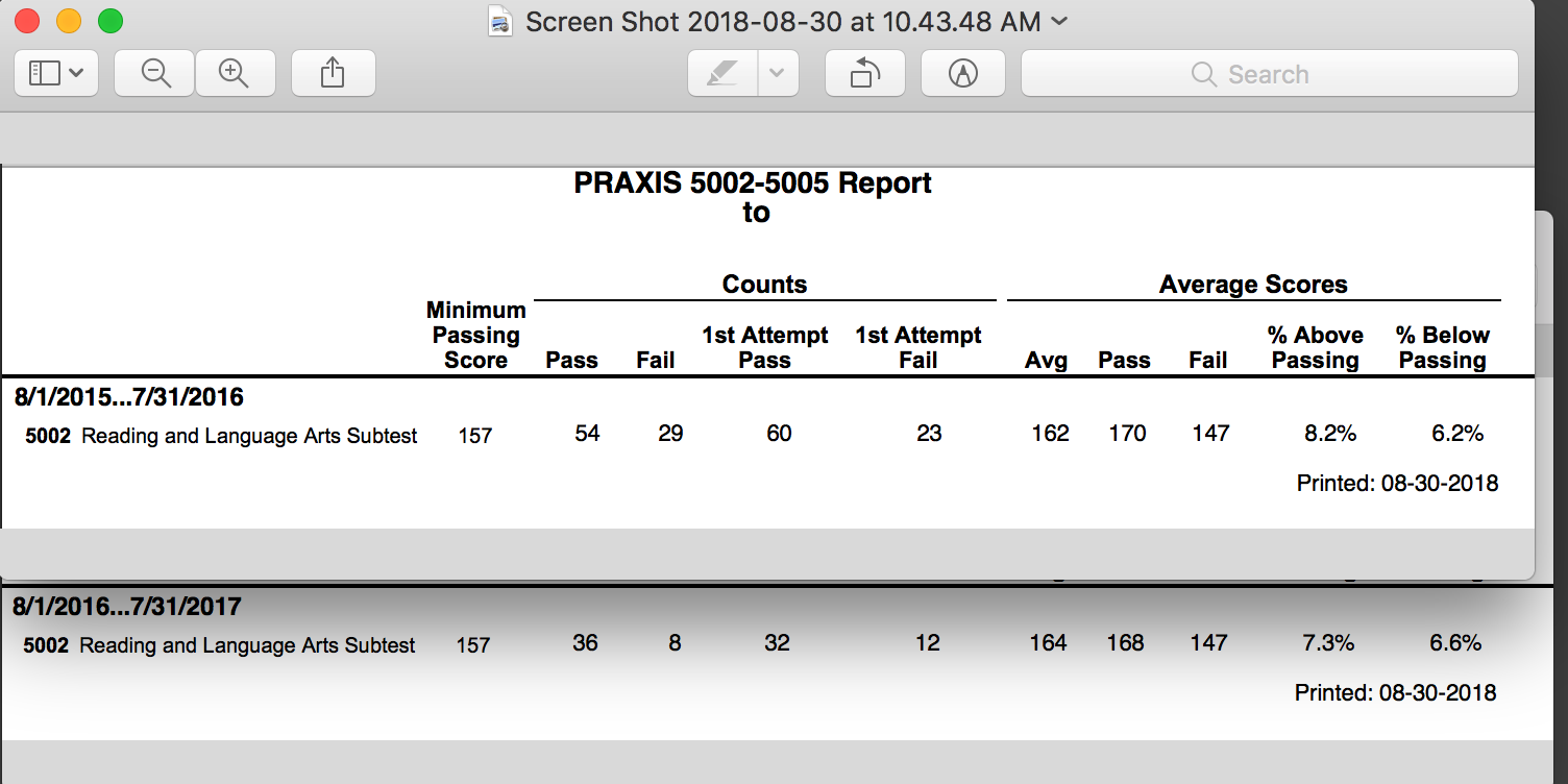

I put together a summarizing report (sub-summarized by date range then test code (i.e., 5002, 5003, 5004, 5005) but where I'm getting hung up is in the last two columns, % Above Passing (score) and % Below Passing (score). As you can see, the numbers repeat themselves for each date range sub-summary...and for some strange reason, the 5003 averages are identical to the 5002 averages, but they shouldn't be.

Hi, Tom:
Attached is the result in Browse mode for Test Code 5002 spanning over two years. The %Above Passing and %Below Passing numbers are correct. However, when I run the scripted report where it sorts by Date Range then Test Code, those two columns' numbers are incorrect.

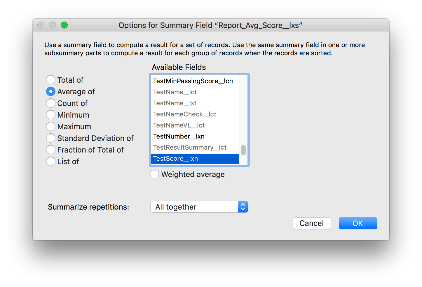

I think the problem is on the field AVG  (164 in the second picture)
How it is calculate ?
Tom
It's a Summary field that averages the TestScore field.

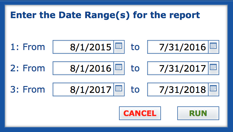

Included is the script to print the report--it's fired by the Report button on the PRAXIS_Child layout; a popover appears where you'll enter the dates in the global fields provided. (I included a screenshot of the typical date ranges we use; I've included records that fit within those shown ranges.)
