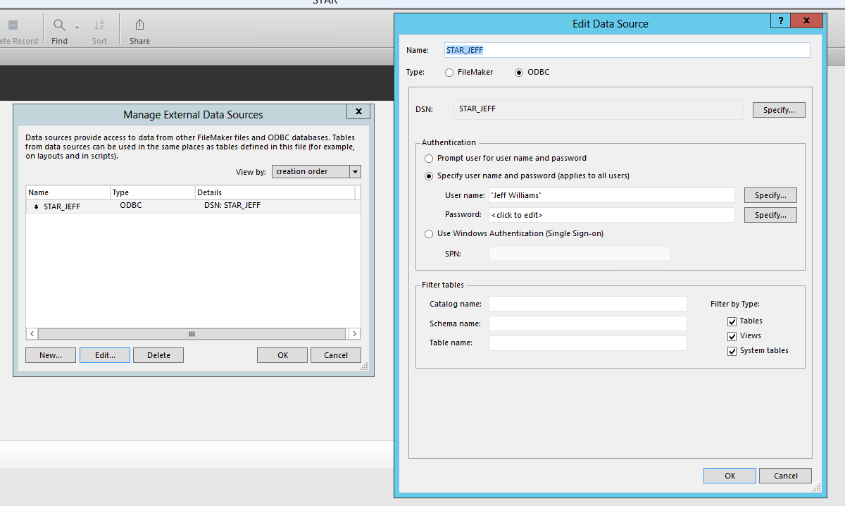

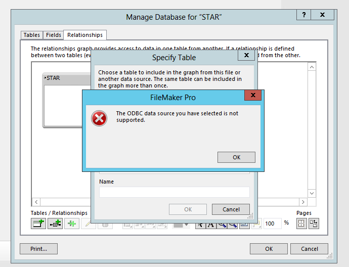

I am using windows.  The DNS shows up inside of FMP as it should. Within the ODBC  manager in Windows I can test the connection and it is successful, so that all seems to be correct. It's after I add the external data source within FMP and then do to manage database to pull in the tables I get the error message. I have attached a couple of screen shots.

I am the user and I have full admin rights. I can connect using a SQL tool using my credentials without any issue. The error that I am getting doesn't seem to point towards a rights issue. The error is indicating a compatibility issue. I was hoping to find someone that has successfully connect to a 4D database through ODBC in FileMaker. There are very few details on the web. Thanks.
What is the database in 4D? It is SQL-lite, correct? That is not supported for ESS ( External Sql Source ). You could do an ODBC import. But that functions very differently.
