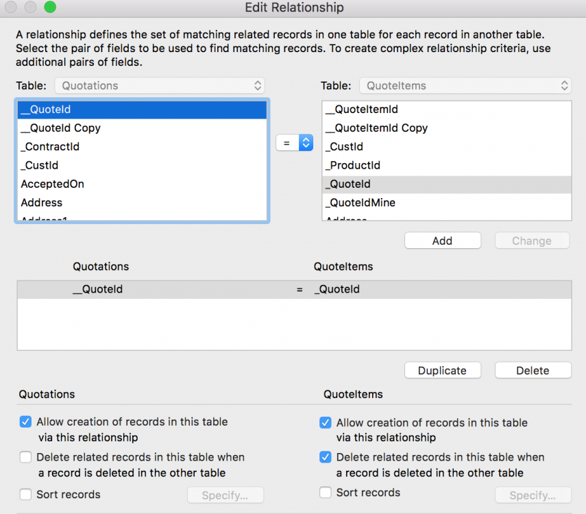

Three ways come to mind that it might happen (but there might be more):
1. You have indicated 'Delete related records in this table when a record is deleted in the other table' on the wrong side of a relationship.
2. You have a Go To Related[] step which fails to switch layouts or accidently isolates the parent Quote records of a record-set of QuoteItems and your script has then issued Delete All Records step on the Quote table.
3. Your User is in a portal and button issues a 'Delete Record' instead of a 'Delete Portal Row.'
The easiest thing to check is the relationship.  It's easy to accidentally specify the wrong side.  It helps if you mark all your relationships by using text to add a plus or minus next to the occurrence where those options are specified.  I also like to include an 's' to indicate there is a sort.  In this way, it will be easier to spot the culprit.
As for #2 and #3, that would require a bit of detective work.  If you use GTRR[] and it is not *properly error trapped, it can fail and if one of your scripts then issues a 'Delete Records', you again can be on parent record set.  I hope it's #1 since you can then fix the issue quickly and still enjoy your weekend. :wink3:

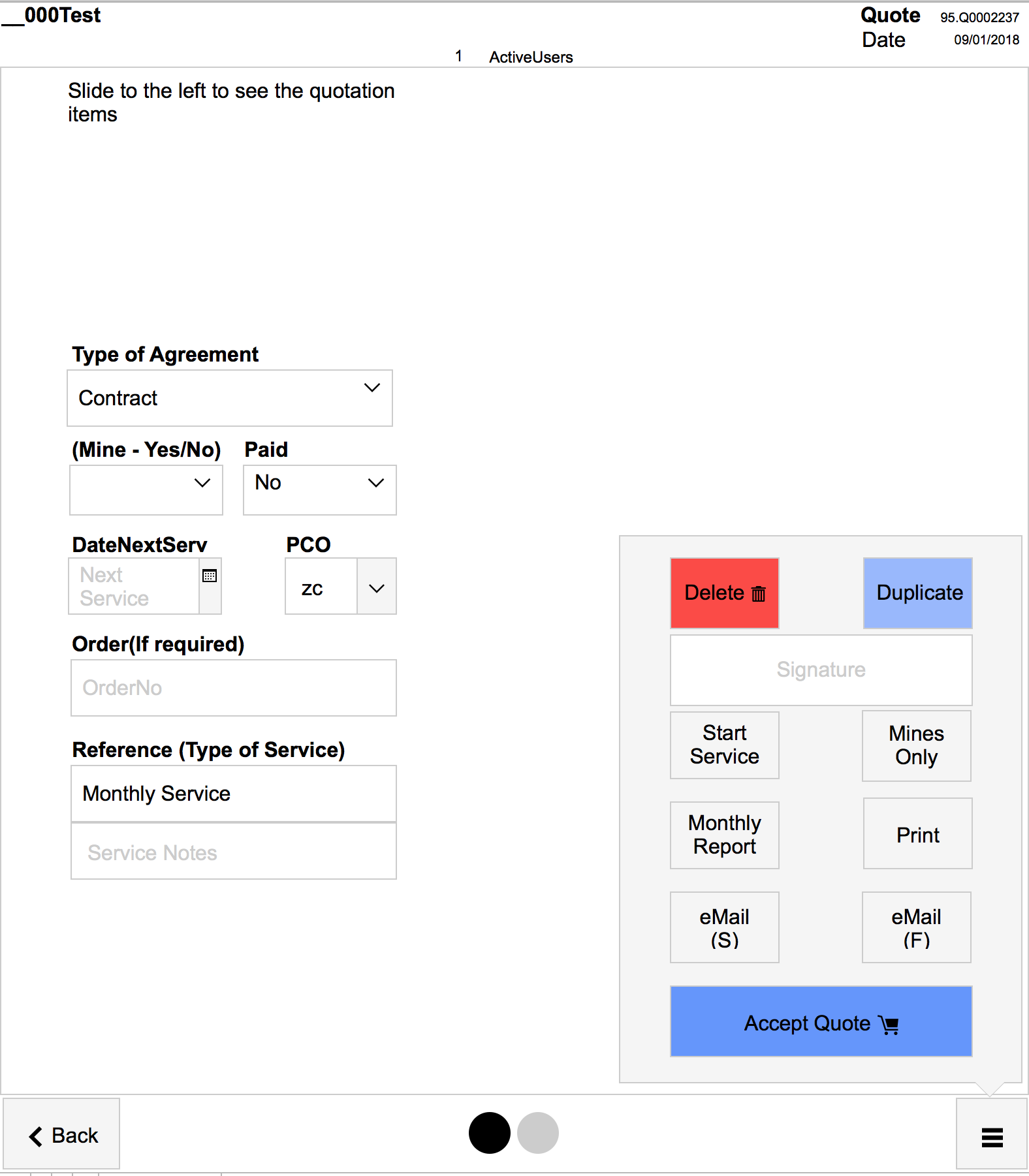

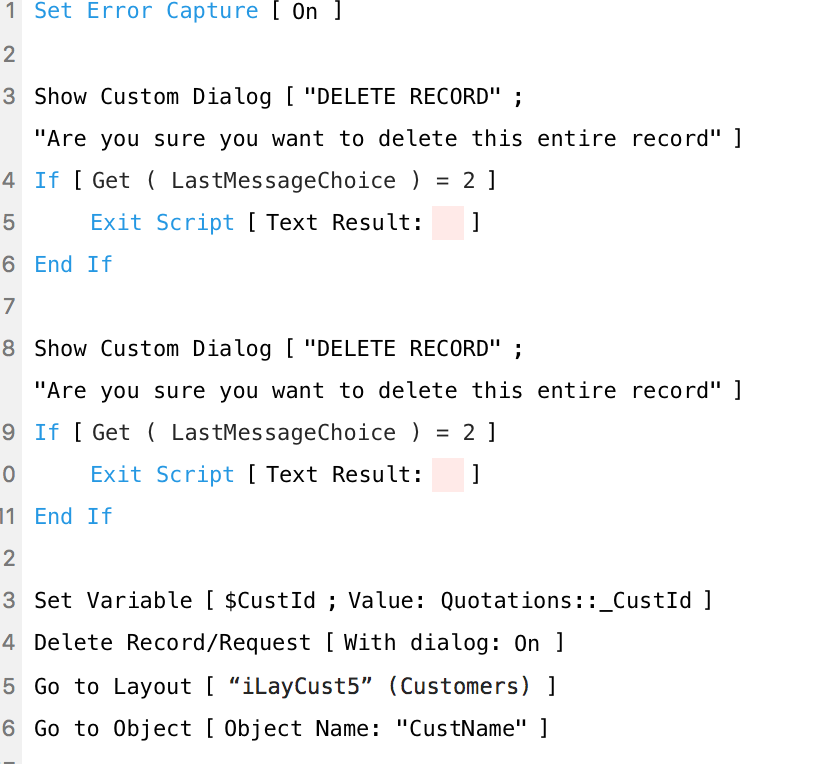

Hi (once again) LaRetta, Thank you for your response. The user can only delete a Quote from the iOS Quote layout using a scripted button, the script of which is very simple so I don't see how your suggestions could operate on the file and I believe that the relationship is set up correctly.
How then are orphans created?  You have IDs with 'copy' after them.  Why?  Is it possible that the parent records aren't deleted but rather their ID has been changed so they are no longer related?   Do you prohibit modification of the primary key ( in field definition)? I also recommend adding detailed error trapping and logging, such as:  Dan Smith's Logger.  Robust logging can help you identify issues.  Maybe until you identify the issue, don't delete but rather flag records for deletion and clean them up later.
It is also possible that the __Quoteid Copy of Quotations is incorrectly holding the parent ID if the parent has been created from within QuoteItems ( since you have Allow Creation on the parent Quotations side).   The __QuotidMine is also suspect.  We do not have enough information to identify the issue.   I suggest you hire a competent Developer to review your solution.  And no, this isn't a plug since I'm not currently available. 🙂

Then why is Allow Creation turned on for the Quotations side?  Nonetheless, I don't believe that addresses your issue.
Tables which must stay in balance, such as Invoice/LineItems or Quotations/QuoteItems should be handled transactionally and when created/edited on FMGo online or offline, it is critical good logging and error trapping be in place.  Please see: Transactions.  I doubt this is something which can be resolved from a forum post, unfortunately.
