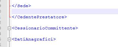

By the way do you know ho to remove spaces between lines.
When open the xml with notepad++ i get this:
....sorry for dumb questions ;)
