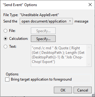

This is one of those "Well, I could swear it _used_ to work..." FMP (PC) problems: I want a script to create a custom-named folder on the desktop (PC) [for exporting data purposes] so I used the following (see attached) Send Event command:
"cmd /c md " & Quote ( Right ( Get ( DesktopPath ) ; Length ( Get ( DesktopPath ) ) -1 ) & "Job Chop-Chop! Backup" )
...in earlier versions of FMP--and if memory serves--it used to work. (See https://fmrift.wordpress.com/2010/02/03/creating-a-folder-from-filemaker-windows/ ). However, when I try to run the script in FMP v17.x the script fails with the following error message in the Script Debugger, "[3] Command is unavailable (for example, wrong operating system or mode)".
So, I'm trying to figure out why the command's failing--could it possibly be it's because I'm using FMP (PC) in VMWare's Fusion PC emulator (v10.1.4, running in OS Mojave) instead of on a "real" PC? Any ideas for a tweak/fix?

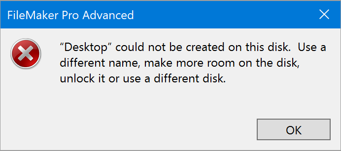

I tried that (enabling Create Directories) but ran into the problem of setting the path, even with the basic Get (DesktopPath)--I get an error message (See attached.)
Even if I can get it to work, I don't see how it will create a folder on the desktop but that could be because I'm being extraordrinarily dense...which is more dense than usual. : )

Can you type the path you used here so we can have a better idea?
It's pretty straightforward:
/C:/Users/WF7A/Desktop/
You did not specify the folder name. Try something like this:
/C:/Users/Siroos/Desktop/test folder/1.pdf
The formula to achieve above can be something like this:
Get ( DesktopPath ) & "test folder" & "/" & GetContainerAttribute ( Yourtable::YourContainerField; "fileName" )

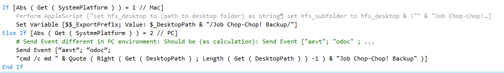

I've attached the script steps that I've been using and it suddenly dawned on me that even with the PC version of FMP running in the PC environment of the emulator, the Get (SystemPlatform) command still pulls the "root" operating system of the computer--which in my case is OS-X (Mojave)--so with the script steps, as coded, the first part of the IF statement will drive the result of it; when I nulled all but the PC's Send Event command, it worked.
Thank you all for your patience and help, and my apologies for taking up your time from my ignorance.
