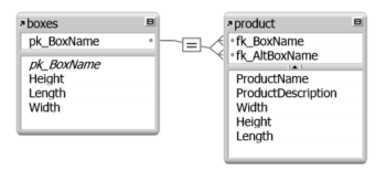

Outline:  Two Table-Product and Boxes
Primary Key:Boxes:pk_BoxName
Foreign Key: Product: fk_BoxName and fk_AltBoxName
Relationship: image.png.e86e6c6177dec47330a362aa3898d8c5.png
What I am trying to achieve--In the product table I am trying to fill in the Width, Height, Length by way of a calculation.

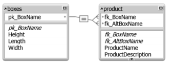

I don't think this is a good starting point.
First, your relationship should be based on a meaningless BoxID, not anything that could possibly be modified later, thus breaking the relationship.
Next, the BoxName field in Boxes should hold the name of the box, and nothing else. You have fields for the dimensions of the box and that's where they should be stored.
Finally, you do not need to duplicate any of the fields in Boxes (other than BoxID) in the Products table. The information from the parent record in Boxes - including the box name audits dimensions - is easily available through the relationship.

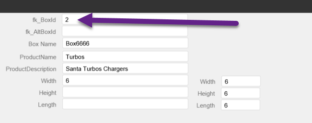

Ok, I get what you are saying.  So something like this would be better--
So this works for one, but not both.
Works if fk_BoxID has a value-

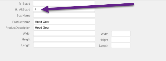

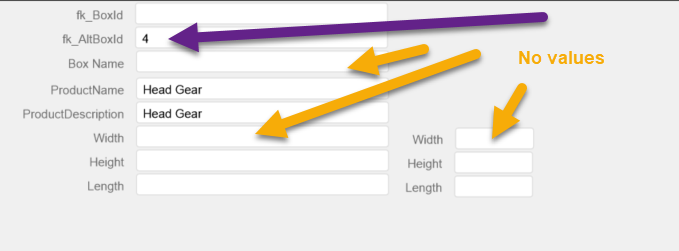

  How would it work if there is a value within AltBoxId.
My issue still remains:
The catch or issue I am having--Case(
fk_BoxIdimage.png.1e68620f31298306e9d6c8af634ff3a2.png "" then use fk_BoxId to get box Height;
fk_AltBoxId image.png.1e68620f31298306e9d6c8af634ff3a2.png  "" then use fk_AltBoxId to get box Height;
"Error")
With the new method, I can see  Width for those products that have a value for fk_BoxId.  But if fk_BoxId is blank and there is a value in fk_altBoxId then the relationship needs to use that value.  (this was why I thought I would need width, height, and length within the product table.  I was thinking I could do a calculation with an if statement.)

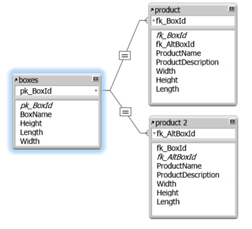

I am not sure I understand the basic situation here. If I am guessing correctly, you need to use two TOs of the Boxes table, instead of (or in addition to) two TOs of the Products table. Then you will be able to calculate, from the context of Products, something like =
Case (
not IsEmpty ( fk_BoxId ) ; Boxes::Height ;
not IsEmpty ( fk_altBoxId ) ; Boxes 2::Height ;
"Error"
Or, if you prefer =
Lookup ( Boxes::Height ; Lookup ( Boxes 2::Height ; "Error" ) )
