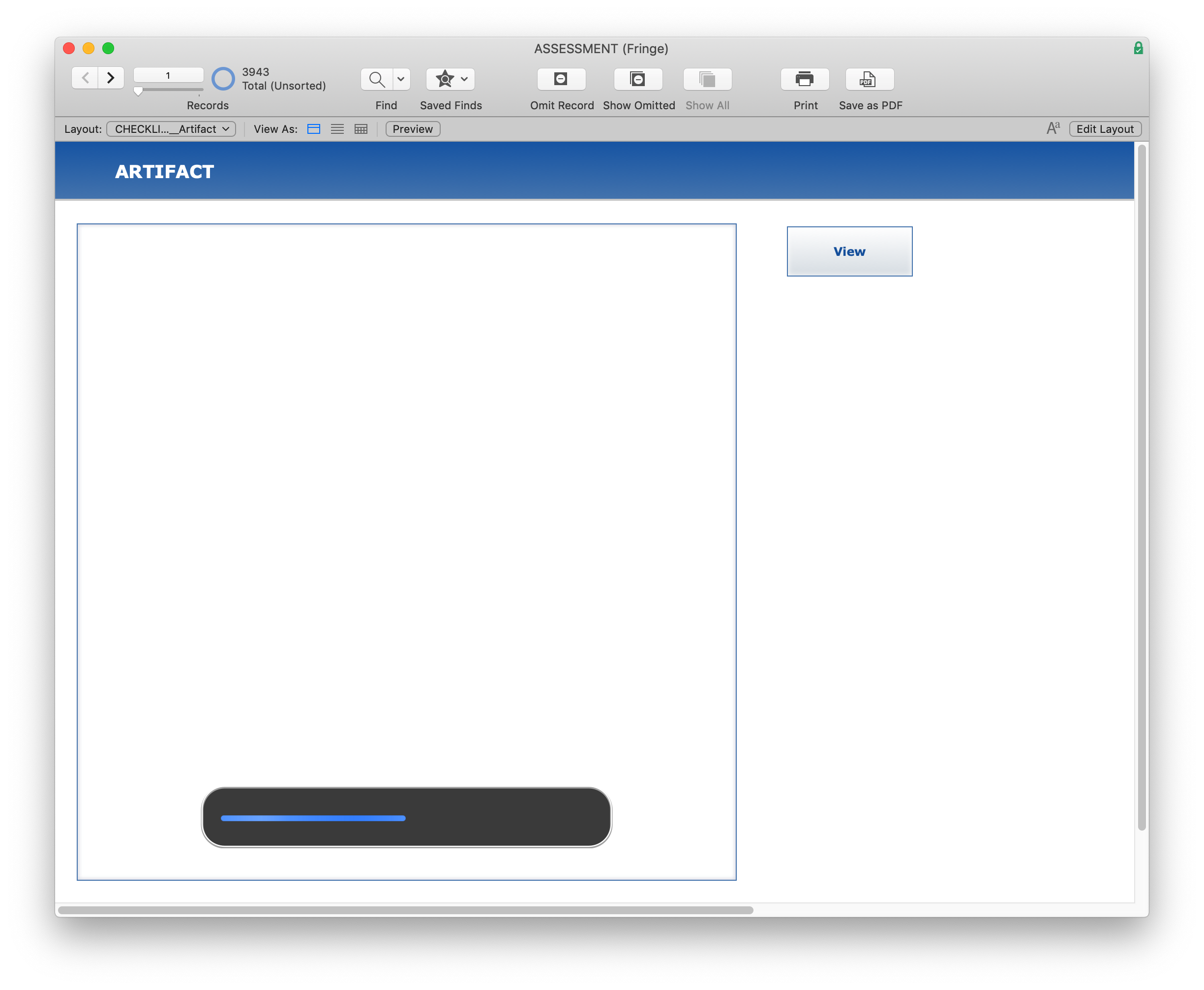

I tried implementing the setup into my solution but I must be missing something since I see this (the attached)--it appears to be trying to load the .pdf  but isn't successful; when I click the button to "Interactivate", I get the Replace windoid ("Records remaining to update") as it crunches through nearly 4,000 records, but to no avail.
Is there an issue when the container's contents are stored externally, perhaps?

Just as an A/B test, I uploaded the Interactivate.fmp12 file, itself, to the server and as-is, the problem's the same: .pdfs "hang", but the other interactive files--.mp3 and .mp4--appear fine.
