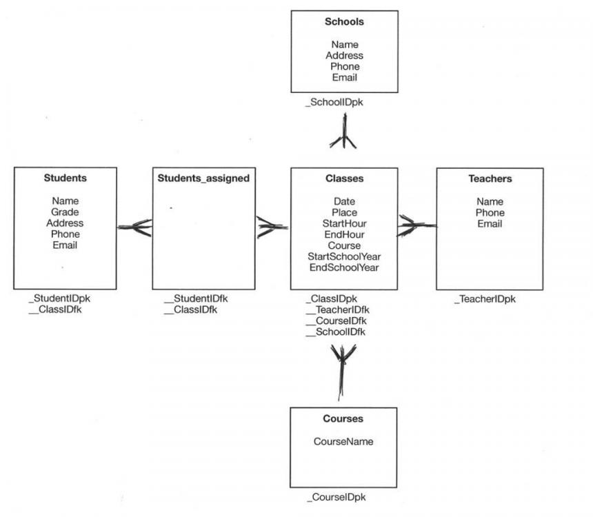

Below you see the ERD that I made. I'm not sure how to proceed now:
Do I need 2 layouts where I filter by school? Can I filter these lessons and the students? And which table will that layout be best based on?

Suppose a user starts by selecting school to work with; you can capture this choice in a global field and use it as the match field in a relationship to present only the selected school's classes in a portal. The same relationship can be used to filter the value lists.

A lot here depends on how you want your user interface to look and behave. If you wanted, you could build this similar to web site, e.g. start by showing schools, giving the option to select an existing school or add a new one. Once they have selected a school, show that school's classes (or departments, if that's the next level). This could be in a portal placed on a layout of Schools. Here again, they would have a choice of selecting an existing item or create a new one. And so on, drilling down in the hierarchy - and moving to a layout of the corresponding table once a selection has been made.
I am not sure why you would want to start from students. It seems to me they should be last - that is, you would be on a layout of Classes, showing a portal to Enrollments, and let the user create a new portal record for each student  they want to enroll in the current class.
And of course you could also offer direct access to any table from your "main" page. So if the user wanted to start by entering their students first (without enrolling them to any class at this point), they could do this too.
This method would also enable you to minimize (perhaps eliminate altogether) the use of value lists for selecting.

I don't see schools in your file. But what's more important, your ERD shows that a student is not related to a school until he/she has been enrolled in a class of that school (and at least in theory, a student could enroll in classes of more than one school). So if you're hoping to start from the Students table, and have a value list showing only classes from a particular school, you would have to select the school first in a global field AND have a relationship based on that global field. Which is why I am not convinced that the Students table is the best context from which to build your interface.

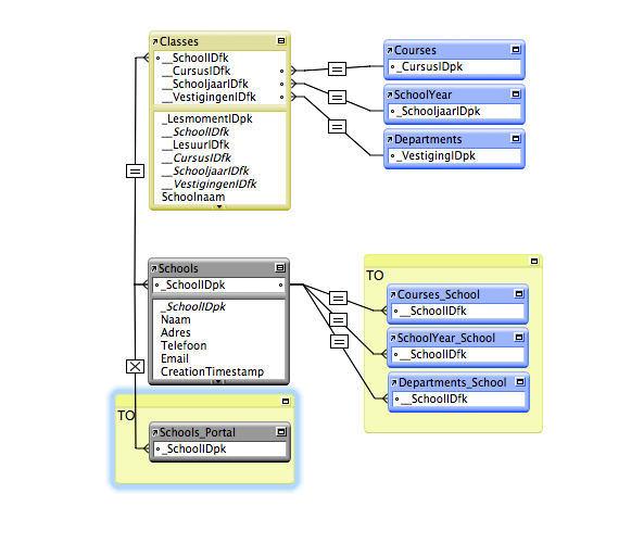

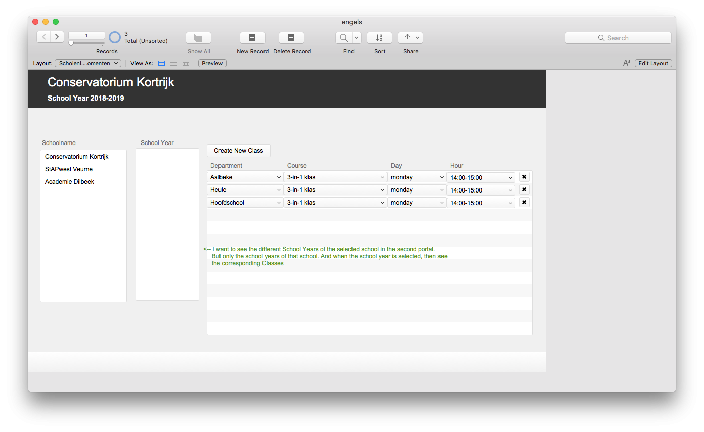

One more question: I am on the "Schools" table and I create 3 schools (so I have 3 records). Then I create Courses, SchoolYear, Departments, etc... All on the layout based on the "Schools" table. So far, so good.
Next step is to create classes. I also do this on the "Schools" table with a portal to "Classes". That works fine but I want to have a dropdown list with the SchoolYears so I can select the current SchoolYear.
Ok, I only need one SchoolYear per year and that is ok but when it is june, a teacher is planning his Classes for the next SchoolYear, so he needs to have the possibility to make his provisional Classes for the next year. And when it is september (new SchoolYear) he wants to start with the new Classes.
How do I accomplish this?
I am not sure I fully understand the question. I think you want to have a global Year field in the Schools table, and use it to filter the relationship to Classes.

If you define an auxiliary relationship (using another occurrence of the Courses table) as:
Schools::SchoolID = Courses 2::SchoolID
AND
Schools::gYear = Courses 2::SchoolYearID
you can use a portal to Courses 2 to show courses in selected year only. If the relationship is allowed to create related records in Courses 2, then any record created via the portal will automatically inherit the parent school's ID and year.
You could also use the existing relationship and filter the portal to show only courses in selected year. But then it's more difficult to get newly-created courses to auto-enter the selected year.
To select the year by clicking into the portal to SchoolYears, define a button that does:
Set Field [ Schools::gYear ; SchoolYears::SchoolYearID ]
and place it in the portal (or make the field shown in the portal a button).
