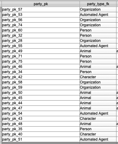

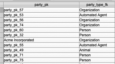

I noticed an anomaly when viewing data in Table View:
The values in the primary key field, in this example, should all have primary key type values - not any other value like a "name". I have checked my data through my filemaker field values in Form View and even exported to data to Excel to verify the data in the primary key field throughout all table records and they are all correct: only primary key data.

Thanks Comment. Your file worked just fine, so that ruled out a version 16 issue.
I have found the culprit: me
I had a field on the layout (doesn't matter that it was in a Tab area) where I attached a Value List I was building for testing purposes. That value list was using the primary key of the same table as the first value, and the second display value was referencing a field in a Table Occurrence that was connected to the table of my layout through a cartesian "x" relationship operator.
As soon as I removed the value list from the field - problem vanished. I reattached the value list to the field and the problem reappeared.
I am assuming the badly constructed value list created a circular relationship and things went sideways from there.
