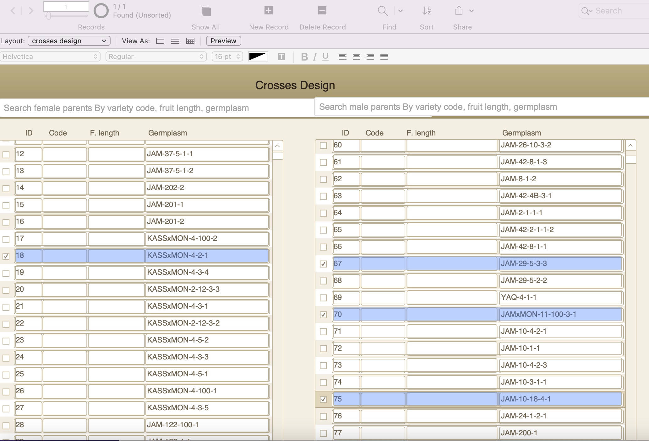

I am trying to combine data from 2 portals (different portal names) which belong to the same table. I need to create crosses by combining (all possible combinations) all selected parents from the portal on the left (portal.female) with those selected from the portal on the right (portal.male). The result in this example should look like:
18 x 67
18 x 70
18 x 75
The result should appear in a different window as a pre-cross list. Then, I need to select from this list my final crossing list.
Any help would be highly appreciated.

This is not going to be simple, I think. Let's start with a better understanding of what you have: are these two portals based on two different relationships, using two different occurrences of the portal table? Or are they just filtered differently?
Now, regarding what you want to have: you do realize that in order to have a list of combinations to select from, you need to have a record for each combination in another table? So the most feasible solution would be a scripted process?
Thank you so much for your quick response. The portals are based on the same relationship just filtered differently. They are fed from the same table which has the whole list of the parental lines. I can make a second occurrence if this can help. Thanks again
Okay, so what exactly do you want to do with those combinations? If you create them as new records in another table, what should happen to already existing records? If you want to keep these, what about possible duplicates? And once this is done, what should happen to the portal selections - do you intend to keep them? There are quite a few options here; the more you tell us about what this process is about, the better we can advise you.

Here is a sketch showing how I would approach it.
Each time you want to create a set of combinations, create a new record in the Batches table, select the objects on both sides and click the Create Combinations button. Hopefully the mechanism is self-explanatory - if not, ask.
