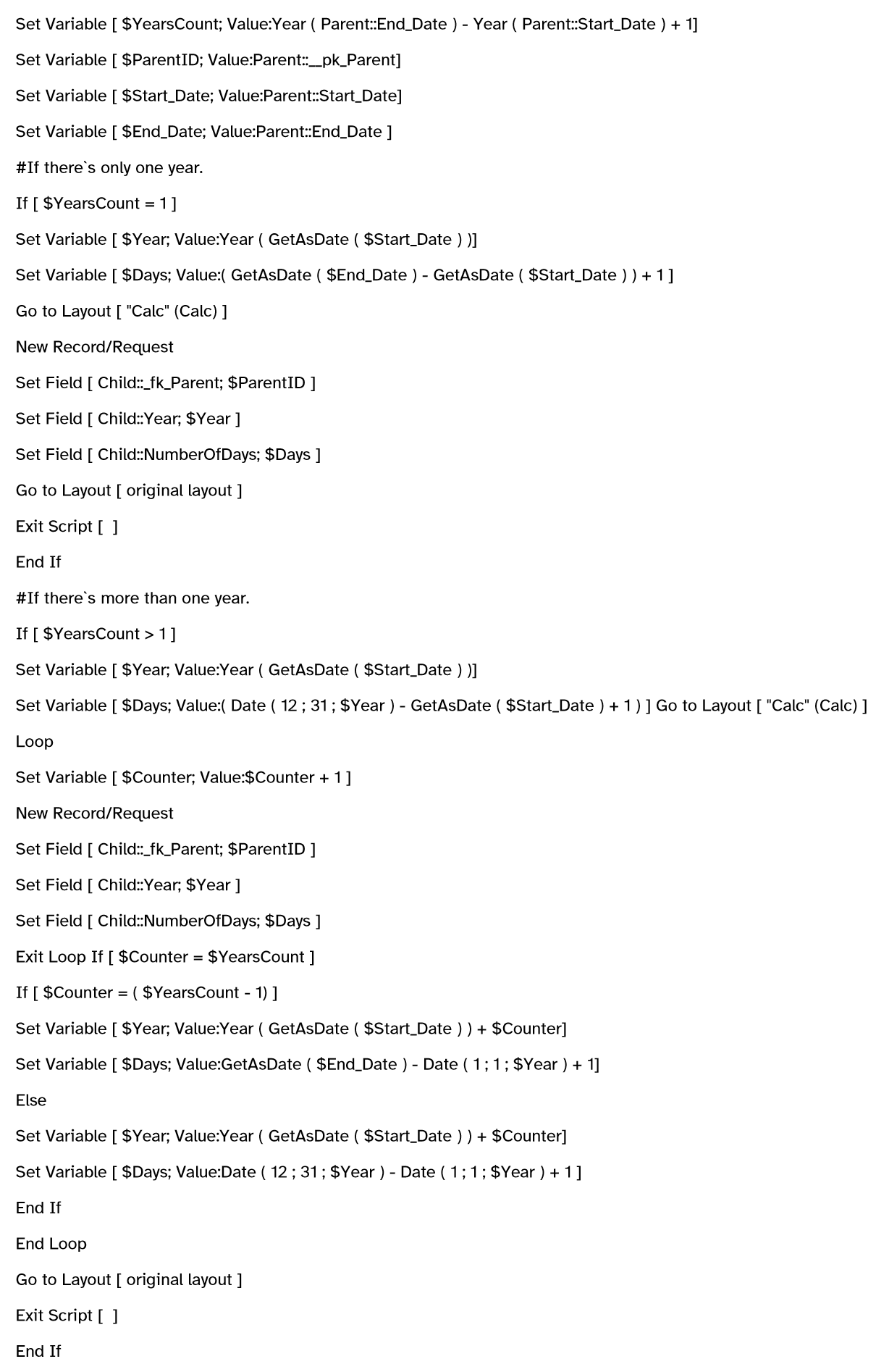

I think I followed the idea (sure "over engineered") but I could make it work.
I really really apreciate the help.
I attach a screenshot of my script so if it can be helpful to someone.
Hm. I believe it could be shorter:
If [ Child::ParentID ]
   Beep
Else
   Set Variable [ $parentID; Value:Parent::ParentID ]
   Set Variable [ $startDate; Value:Parent::StartDate ]
   Set Variable [ $endDate; Value:Parent::EndDate ]
   Go to Layout [ “Child” (Child) ]
   Loop
      Exit Loop If [ $startDate > $endDate ]
      Set Variable [ $year; Value:Year ( $startDate ) ]
      Set Variable [ $endOfYear; Value:Date ( 12 ; 31 ; $year ) ]
      New Record/Request
      Set Field [ Child::ParentID; $parentID ]
      Set Field [ Child::Year; $year ]
      Set Field [ Child::NumberOfDays; Min ( $endOfYear ; $endDate ) - $startDate + 1 ]
      Set Variable [ $startDate; Value:$endOfYear + 1 ]
   End Loop
   Go to Layout [ original layout ]
End If
As always, great help comment.
Works great. And I'm still trying to figure out how can you do it so simple.
This seems so obvious and logical when you see it... But I would never have thought of it.
I really appreciate the help. Thank you very much.
