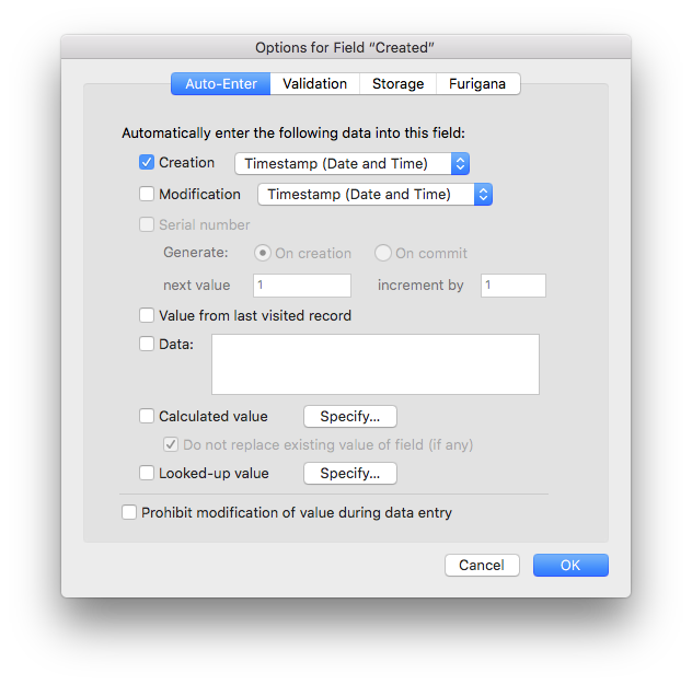

2. In Options/Auto-Enter, selected Creation: Timestamp (Date and Time)
If that's where you want to have the local date and time to be inserted upon creation of a new record, then that is all you need to do. No additional "tweaks" should be required. Under what circumstances are you getting a different result (and what is that result)?

And if you need this as auto-entered creation timestamp, then you don't need any calculation at all. Just tick the Creation checkbox, select Timestamp (Date and Time) and you're done.
