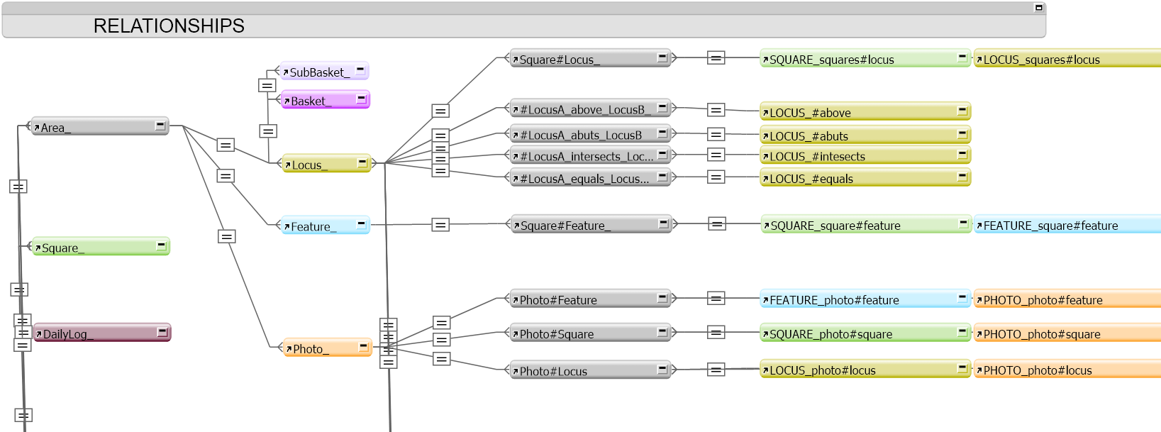

I've attached my graph. The two tables are Locus and Feature. As you ca see, Locus is a much more elaborated entity. Also, the naming (the pk) of the records in them is different. In the Locus table I have a field that should hold a name of either a Locus or a Feature in the same area.

Nice graph! 😺
I see you want the selection in the Locus table instead of Area - that is fine.  The solution uses value lists of each table and the resulting Select field holding the selected ID can be anywhere you wish.  Same with the Type field.
