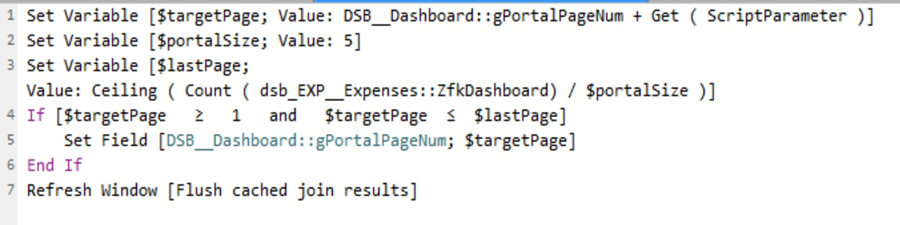

Good Morning,
So the script now does not exceed the minimum and maximum page number. This issue is resolved.
As for the conditional formatting, it works fine on the left arrow but for some reason that I can't manage to identify, the right arrow behaves differently. The portal on which I'm testing this has 18 pages. When I reach page 18, the right arrow button does turn to grey but as soon as I move the cursor away from it, it loses its formatting and goes back to white. Any idea what can explain this?
The formatting condition on the right arrow is DSB_Dashboard::gPortalPageNum = $lastPage. And below is the script.
The scope of a script variable (prefixed with a single $) is limited to the duration of the script. So while the script is running, the $lastPage variable is equal to 18 and the condition is true. When you move the cursor away from the button, the button is redrawn (because it changes its state from Hover to Normal). But at that time the script has already run out and the $lastPage variable no longer exists.
You can test this by adding a pause of a second or two to your script. Then you will see that the button will remain grey when you move away from it, and return to normal only when redrawn again.
A possible solution is to make the variable global (prefixed with  $$). But then you need to consider what happens when you switch to another record, where 18 may not be the last page number. Because a global variable persists until the end of the session (or until you cancel it by setting it to empty).
Thanks for your very clear explanations.
I have found a workaround. I've created a text field LastPageNumber in the Expenses table, added a script step that sets that field to $lastPage and changed the formatting condition to DSB_Dashboard::gPortalPageNum = Expenses::LastPageNumber. And so even when the $lastPage variable ceases to exists, the text field LastPageNumber keeps its value.
Thanks again for all your help.
If you want to use a field for this, then it should be a calculation field defined in the Dashboard table. And the result type of the calculation should be Number.
Perfect. I've made these changes. But just so I understand the rationale, why should the calculation field be in the Dashboard table?
Because it needs to count the number of related records in the child table, from the context of the current parent record.
Thanks very much.
